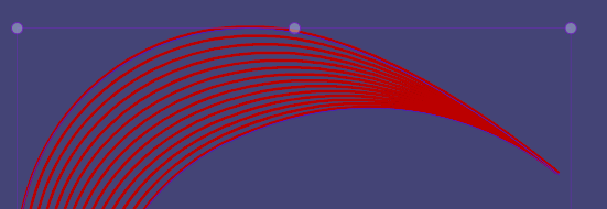

Well, work in progress here. I started this and it is fine:

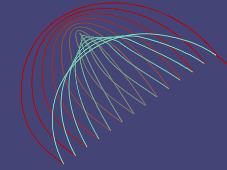

I want to get the same path for the blended objects with another object and I get this (I change one colour to show you):
but I would like to get a crescent shape and not this semi-circle shape. I've changed all the parameters of the blending but no way. Any idea ?
@Pat What is the direction of those two shapes?
When hovering with the Node tool over the shape, a small arrow indicates the shape direction.
In blending the start of one path is matched with the start of the other.Object -> Shape -> Reverse Path Direction can be used to change the direction of a path.
I don't know what happened. I've started again from scratch and it is fine now. I'll check later to see if I can find the issue.
@VectorStyler You were right. I didn't pay attention & I did draw one stroke in the other direction

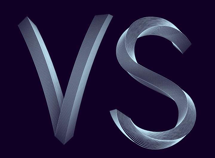

@Pat This is really nice!
@VectorStyler Thanks .... just heavily testing blending
Like your "VS" too very creative
