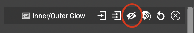

        The effect of the Angle is very small, as it controls the direction of the blur, not the direction of the glow.
        @VectorStyler Is the angle in drop shadow also for controlling the direction of blur and not the angle of light/shadow?

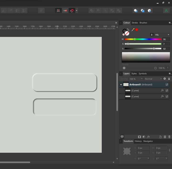

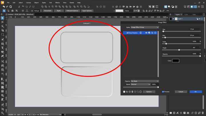

            @VectorStyler What I am doing to do in create button pressed and normal state like the image below:
            But when I apply outer shadow and increase blur it bleed to all direction.
            I found the there is no offset of control of shadow like this.

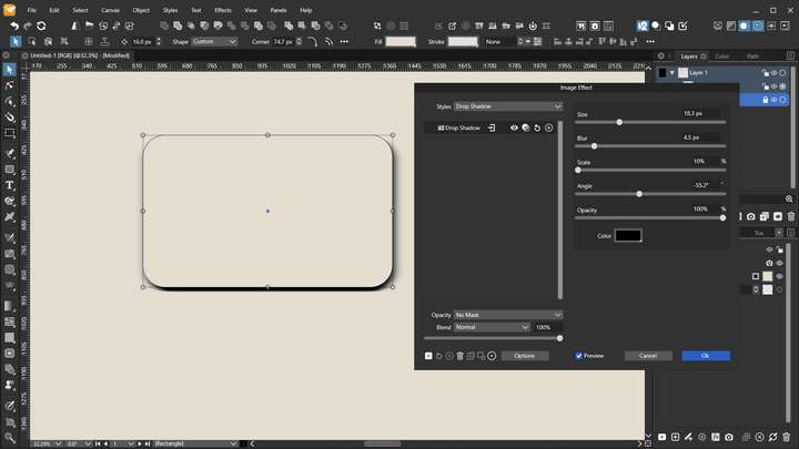

              @Jayanta-Das I'm not sure that it applies to this case, but in Drop Shadow there is the Size field that controls the offset.
                VectorStyler @Jayanta Das
                @Jayanta-Das As for the other images, I think these look more like using Emboss.

                  @VectorStyler Emboss effect applied within the shape. I am trying to get neumorphic style button where shadow and lights are applied to outside of the shape
                  Edit: When the button is in pressed state effects are applied inside the shape and in normal state effects are applied outside of the shape.
