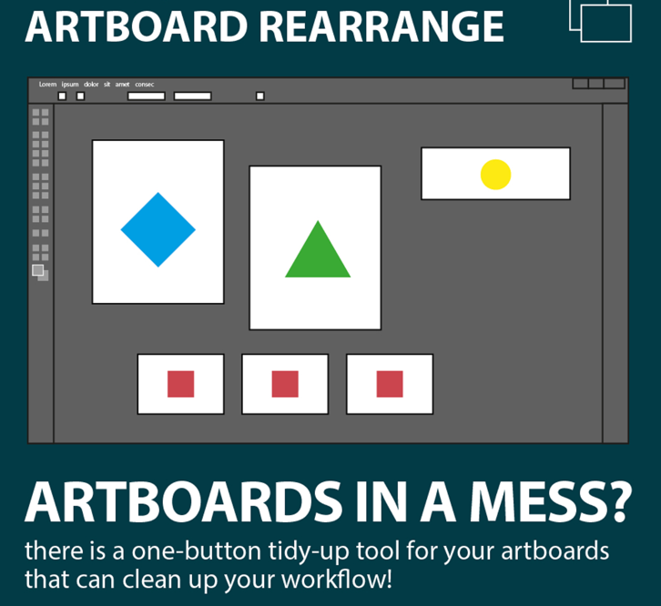

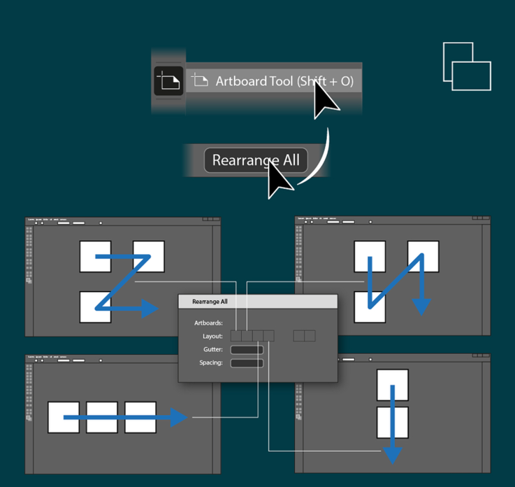

Option to rearrange Artboards
This could come in handy. If added, it could be a option inside the "artboard options" tab in the contextual menu.
@Boldline There is a Canvas -> Arrange Artboards command that does this.
