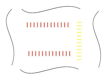

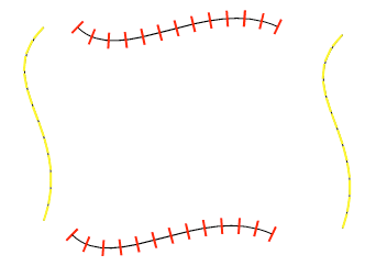

I made the strokes in the direction I wanted them to goBut if I align them from left to right or right to left
strokes will always be rotatedi used this one to align the Strokes
the result should look like the right one

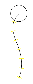

@Subpath When aligning to path, the objects are rotated to the path direction. This rotation is relative to the base axis.
In this case all the yellow lines are horizontal, so they will appear as they are along the path.
Rotate all the yellow lines by 90 degree (to be the same as the red ones) and try with that. -
@Subpath Try convert to curves on the yellow lines.
