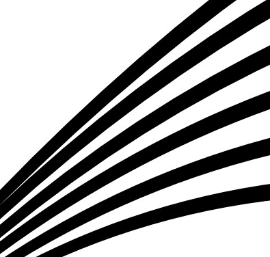

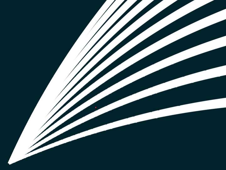

      I always have rendering artifacts with VS that I don't have with AD for example. What could I change so that I don't have this anymore:
      VS:
      AD:
        b77 @B-Vs-V
        @Pat Looks like something related to the graphics card.
        Can you share a file with this part only, for us to test here?
        • B Offline
          B-Vs-V
          I forgot to mention: W11, nvidia gtx 3080 & the gc drivers are up to date.
          @b77 Thanks, here is the file containing the graphic shown above:
          0_1670758673781_Test_rendering.vstyler

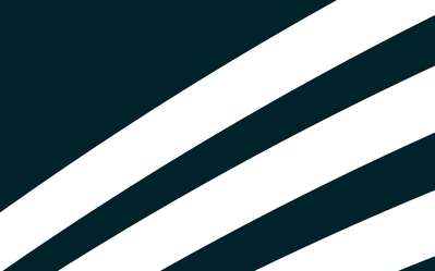

            b77 @B-Vs-V
            @Pat Clean rendering here with AMD Radeon Pro 455 2 GB:

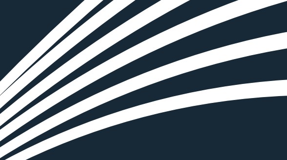

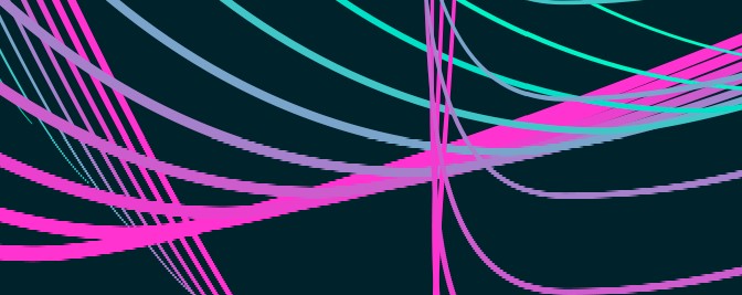

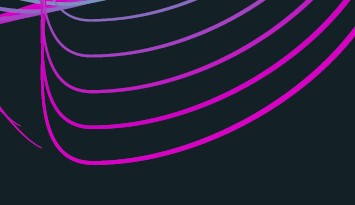

              @b77 Thanks for testing It only happens with VS. Here is a much more complex AI file & the rendering is perfect... as in AD.
              The 'subpixels' is set to maximum. There are many display features I can change in VS but I'm not sure what to do & prefer not to go by trial and error ☺
              AI:
                @Pat
                everthing seems fine her too
                Subpixel are Maximum, Win 10, Gforce rtx 3070

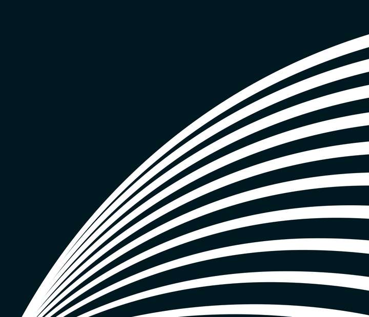

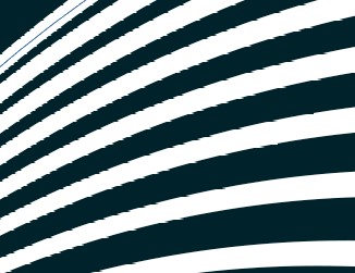

                      @Pat Occasionally I have such an artifacts in VS also. They are rare and not dramatic.
                      On your symbols they are only in upper parts, next to "joining":
                      PDFs are crisp though. (Win 10, GTX1650Ti - laptop)

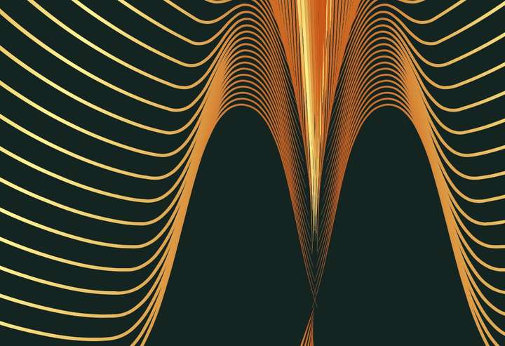

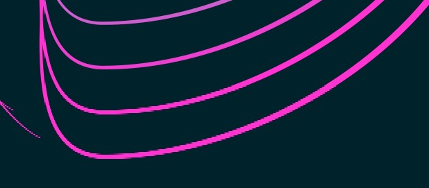

                            @Harry I always get those artefacts and indeed, pdf export is fine.
                            PDF:
