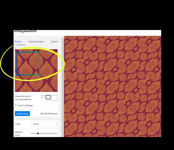

      Harry
      Since we have Patterns and Tiling in VS, it would be great to have some kind of seamless pattern generator like for example combination of those two:
      https://www.wowpatterns.com/pattern-maker/app/
      and
      https://patternico.com

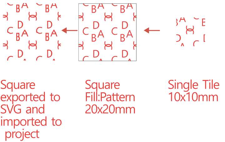

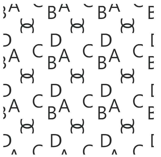

          @VectorStyler Could you show me how to make a pattern that would be repeatable in each direction?
          I created the tile below in VS, but it wasn't easy. Additionally, after exporting and trying to create a larger area, it is impossible to merge them into one object. When editing mode is enabled, the lines are visible.
          SVG tile
          0_1671125326690_ABCD pattern tile.svg
          I also tried using the tile as a square fill and then exporting, but there was displacement in the resulting file .
            VectorStyler @encart
            @encart said in Seamless pattern generator:
            The above example is such a pattern. As long as the pattern edges align, it will be repeatable.
            I think one problem here is that VS does not "fuse" the shapes from different pattern tiles. This does not exist for now.
            As for the SVG export, I also noticed an extra overlap between the tiles. This might be an error in the SVG export (of VS) I will investigate this more.

                    I meant something more automated - like in links I posted above

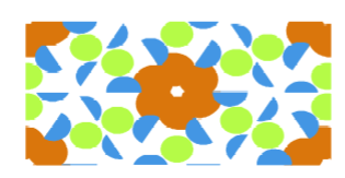

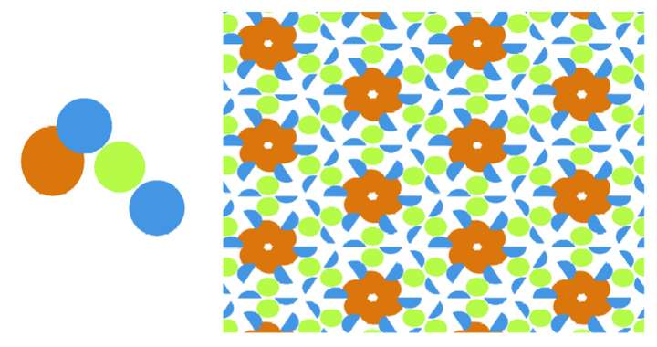

                    For example: I have a simple object and triangular tiling pattern:
                    One tile for seamless pattern could look like this:
                    Is it a way to automate this in VS? I tried to do it manually, but results are not perfect.
                      There is no way to automate this at this time.
                      For now, the pattern tile must be designed so that the edges match perfectly.
                      Are there apps that do this automatically?
                      I'm not sure if this is possible for any kind of tile design.

                            I meant some sort of "automated" frame to adjust seamless pattern like in https://www.wowpatterns.com/pattern-maker/app/
                            In addition to setting the pattern correctly, you could also experiment and get interesting results.

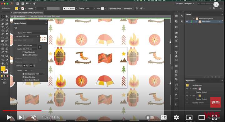

                                    in case you may not know, you could create
                                    some of that Patterns from "Wowpatterns"
                                    with Clipping Objects in VS is a little more work
                                    but do able i think. In the end you have to choose
                                    the Section you like and create a pattern from it.
                                    I record a Video here to show some steps
                                    will also do a little Tutorial which take some time
                                    here the video

                                          @Harry
                                          The Tutorial is online, you found it
                                          in the Tutorial Section.
                                          Here the LInk
                                          https://www.vectorstyler.com/forum/topic/2801/how-to-create-pattern-fills-with-clipped-shapes
