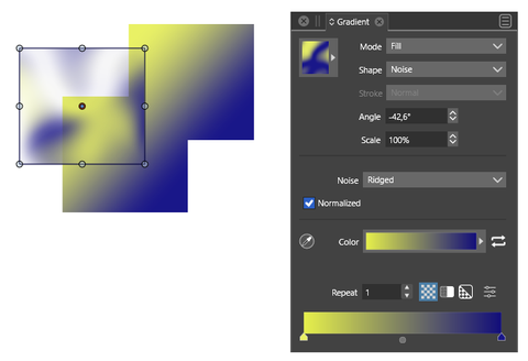

      VectorStyler @Subpath
      @Subpath Click on the second icon in the row starting with the "Repeat" label.
      This will allow the control of opacity.
      Otherwise the opacity is generated by the noise.

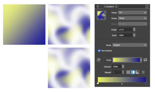

        Subpath @VectorStyler
        The second icon doesn't seem to do anything and neither
        does the third. Everything looks the same and stays the same.
        Also, the shape dropdown menu displays incorrect information.
            @VectorStyler said in Unintentional Opacity in a Noise Gradient:
            @Subpath Send me a file with those gradients from the recording. I will try to figure out what is wrong.
            File is sent

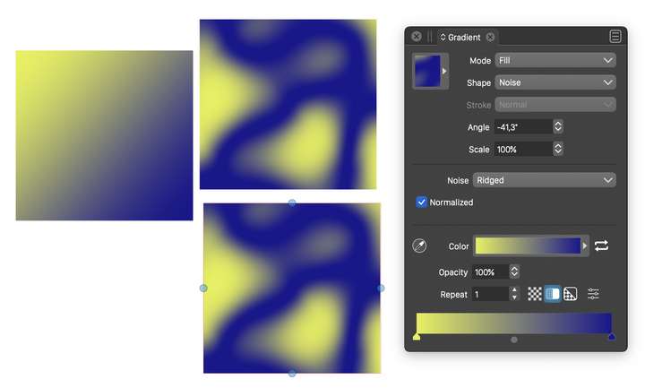

                @Subpath This is how it looks here, after set the gradient opacity mode to the second icon:
                I will return to this on Windows later.
                  @VectorStyler , thanks
                  definitely looks different from mine
                  This problem is not urgent for me, it caught my eye
                  and I wanted to mention it
                  here my result, new try
