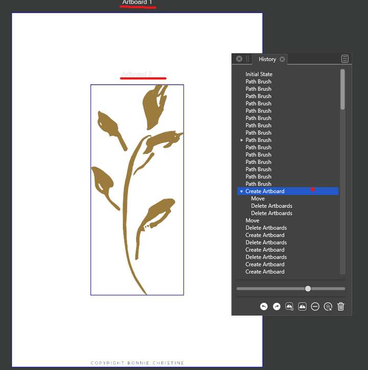

      This is going to sound a little bit silly, but I was looking for a 'convert to artboard' option like in AI. Experimenting a bit and looking through the forum I found this option is not there (yet) but, looking back on my screen, I somehow managed to envelope the object on its own artboard. It is exactly what I was after, but I cannot figure out how I did this - there were no popups or settings that I okay'd and I did have the object selected. The history panel does not reveal any clues (but 'create artboard') and I have not been able to do it again. Any clue is welcome!

        @syllie if you move the art off the main artboard and then click on the art board tool in the vertical toolbox on the left, it should make a second artboard the size of the selected object
          b77 @Boldline
          You need to click (once) with the Artboard tool on the object, and an artboard is created.

              @b77 Close - but that gave me a clue how I did it and it can be reproduced. On windows this is:
              • Select artwork
              • Activate artboard tool -> right click on artwork. Ignore popup.
              The artwork is then enveloped by the new artboard.
              Note: it does not matter if artwork is on an existing artboard or outside of it.

              When I move the artboard tool (inside an existing artboard) / or (over artwork outside of an artboard) the cursor changes to select tool. Right clicking creates the new artboard (dismiss context menu with Esc).
              Note sure if this is intended behaviour, but that is what happens on Win10.
