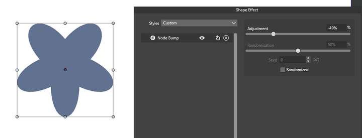

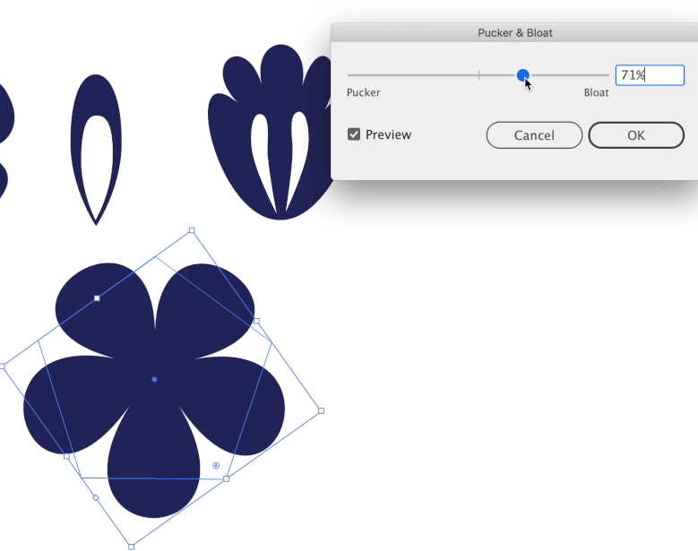

      I found this discussion about Pucker and Bloat https://vectorstyler.com/forum/post/7756 where the objective was to create a diamond. There is now an effect in VS that sortof mimics this behaviour Effects > Outline > Node Bump, however the pucker is much less elegant. What would be the easiest way / best tool to get the luscious curves similar to the AI effect?
      AI:

        VectorStyler @syllie
        @syllie No such effect.
        syllieS 1 Reply Last reply Reply Quote 0
        • syllieS Offline
          syllie @VectorStyler
          @VectorStyler aww.. okay - it is quite primitive and easy to make but would have been nice! Thanks for the feedback.

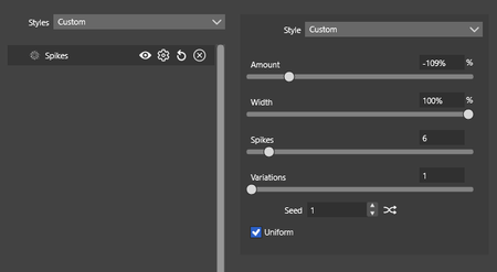

            had a kind of result with
            the Shape Effect > Distortion > Spikes
            (original Shape was a circle converted in curves)

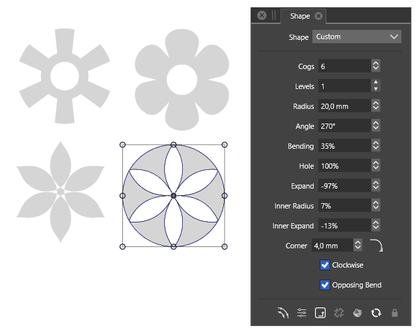

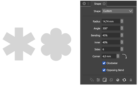

            the shape panel offers also a few options
            in conjunction with these Smart Shapes here
            Tip: change also the Value in the Corner field
            b77B syllieS 3 Replies Last reply Reply Quote 4
              b77 @Subpath
              @Subpath What was the initial shape in the Spikes example?
              A squared star? A normal star? I can't get the same effect here.
                Subpath @b77
                @b77
                it was a circle, had a example from a illustrator video
                the circle was converted to curve
                  b77 @Subpath
                  @Subpath D'oh! 😆

                    • syllieS Offline
                      syllie @Subpath
                      @Subpath @b77 @Boldline Thank you all for chiming in! It is SO good to see this kind of collaboration and hints and tips to get a more complete picture of options. These shapes are much closer to what I had in mind and definitely an option. Thanks Subpath for bringing these settings to my attention!

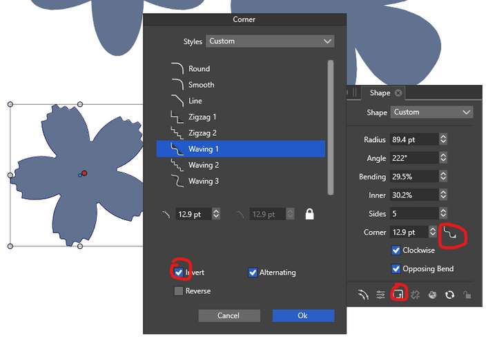

                      • syllieS Offline
                        syllie @Subpath
                        @Subpath said in Easiest way to do "Pucker" effect in VS?:
                        This one is super interesting as the shape of the corner can be edited further to give very interesting outcomes:
                        Add to that the option to edit the corner shapes and the sky is the limit:
                        https://www.vectorstyler.com/documentation/shapes/editcorners/#create-corner-shapes
