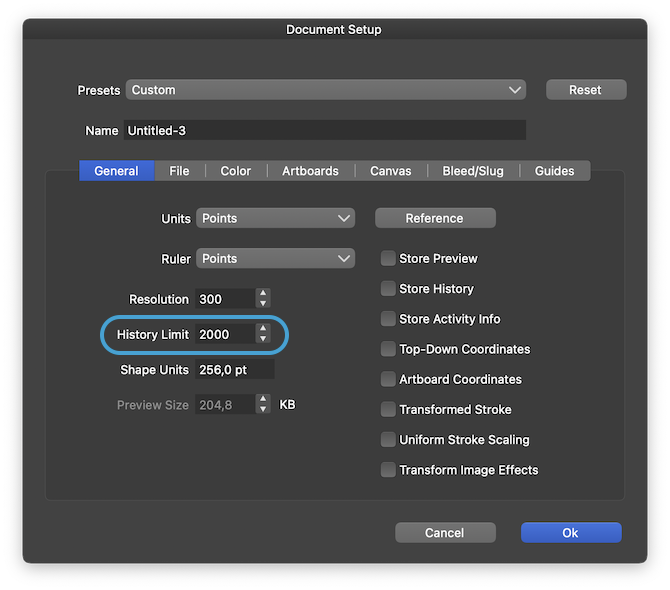

      Can someone tell me how to setup unlimited undo's please? I searched through settings and could not figure anything out. This is very important! Also, does this forum allow paid requests?

        I don't see a way to setup unlimited undo, but you can change the undo steps here in
        Document Setup (Cmd-Shift-P):
        Also: the History panel (Ctrl-H) has an Undo/Redo slider. 👍
