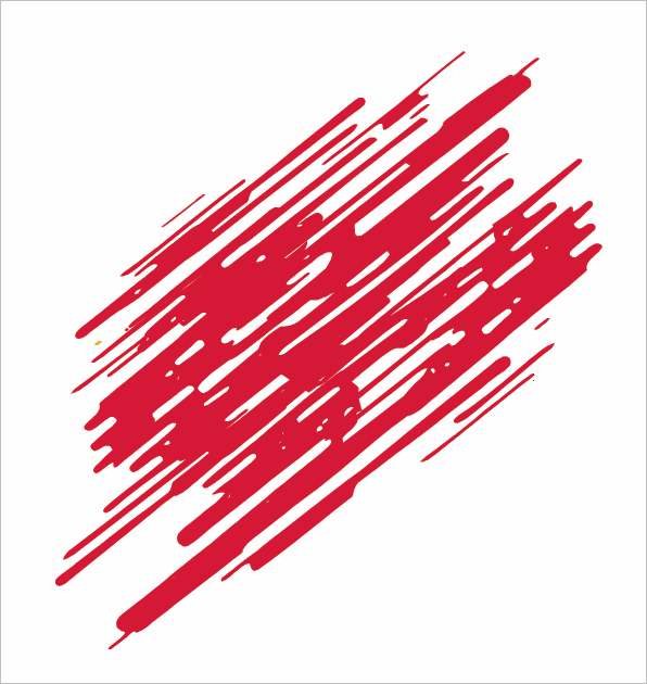

      0_1683056189036_deleting nodes multiple times.vstyler Here is the source file if you want to test it on any negative space shape
      Here is a screenshot step by step of the issue:

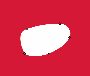

      I have a shape I want to remove specific negative shapes from.
      0_1683056279067_1dc8a74e-f9fd-4728-8b7c-453832053e22-BLD 2023-05-02 at 15.37.12.png

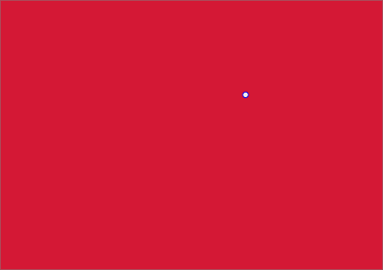

      Zooming in, I want to remove this entire circular negative space shape - I select the shape using the shape editor tool and then delete

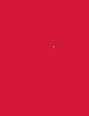

      Everything disappears as expected except for a small triangle and path line - so I delete it again
      Then I am left with a circle shape node - when I delete it this time, it fully goes away

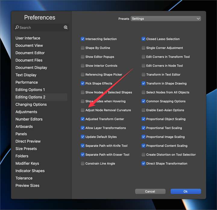

                @VectorStyler I think I found the issue!!! I had turned off the "Adjust Node Removal Curvature" earlier today because for the specific task I was doing I did not want it to adjust any curves when I deleted nodes. (love the feature for most of my work!) When I turned this back on in preferences, it deleted the negative space correctly and as expected.
                Is there a way to fix this so even when that setting is off, it will still fully delete a fully selected inner shape?
                0_1683058000258_f8ef3ce5-2821-4b95-838c-2d1b70d89a50-BLD 2023-05-02 at 16.06.00@2x.png
                  @Boldline Replicated the problem. It should be deleting also with that option disabled.
                  Will be fixed ASAP.
