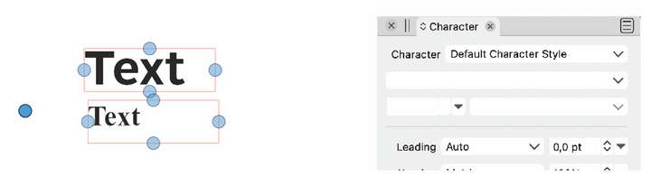

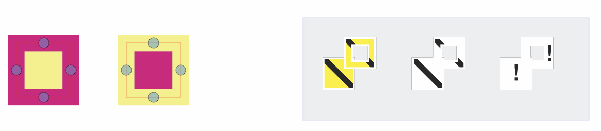

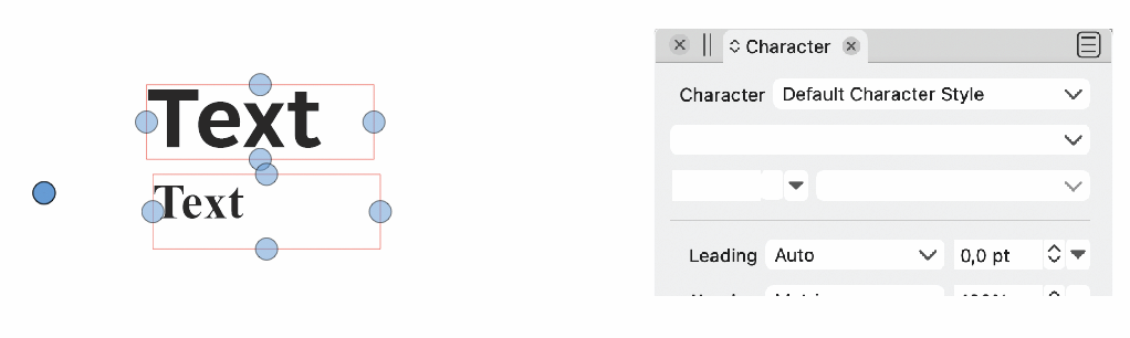

      2. Selection of multiple styles
      Selections with contains more than 1 color, font, stroke weight, style, size etc. gives no feedback in the way of being 'multi-defined' in selector panels. Selectors seem to give first selected value. This should be of blank or a multi-defined sign like a gamut warning or so.
      This is important UX feedback to check if there are any errors in your artwork such as an unintented strange styles.
      To the left selected items, to the right suggestions for color inspector
      To the left selected items, to the right blank fields

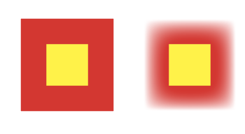

      6. Effect like Feather.
      All blurry image effects are affecting the total shape. A feather keeps the inner shape sharp. This would be a nice feature. like so...

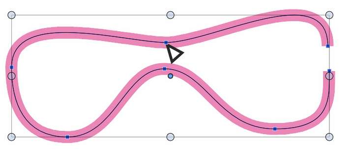

      8. Self snapping
      Snapping a multi-node path only wants to snap to itself with the end nodes. A middle node does not snap to another node on the same path. See image; the top middle node in pair of glasses shape will not snap to the node below. Not a big deal but strange.

        1. Self snapping
        Snapping panel menu -> enable "Snap to Original" option

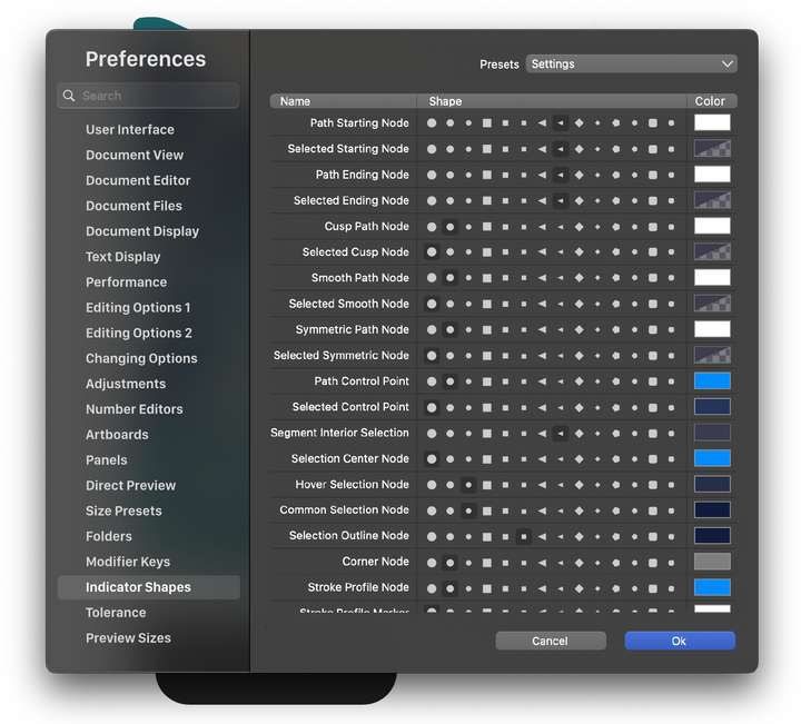

            The Preferences panel will be simplified a bit in 1.2 but the node indicators list will be the same. Not sure what is a good solution here.
            I'm resubmitting this idea:
            VectorStylerV 1 Reply Last reply Reply Quote 3

              As for the indicator shapes, I think the problem is not so much understanding the shape and size and color as understanding the species names. What is the difference between a Common selection node, Path control point or Stroke profile node.
              Try yourself
              Draw a simple line and change the appearance of the nodes. Not easy at all.
                VectorStyler @b77
                @b77 I will try to implement that preferences view.
                EDIT: but one problem is that the color setting and the shape setting are not done on the same indicator set (colors can be changed for more indicators).
                  b77 @VectorStyler
                  @VectorStyler If I understand correctly, some colors are hardwired to multiple indicators.
                  In that case, listing those indicators one after the other could help with this — so that
                  when you hover the color button all four can highlight with a thicker light gray stroke
                  around the button?
                  Also: using an empty row as "separator" between groups of indicators can definitely help.
                  Question is what the criteria for grouping should be used — selected and unselected?
                  Object mode and Node editing mode?
                    b77 @Ayo
                    @Ayo said in Ten points for VectorStyler, my experience and ideas:
                    'Snap to itself'
                    • Victor VectorV Offline
                      Victor Vector @b77
                      @b77 I love your idea for the node Indicator Shapes preferences!
                      So fast and easy to see!
