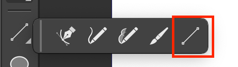

- Draw a line segment with the "Straight Line" tool. Don't draw a horizontal or vertical line. Draw it in whatever angle.
