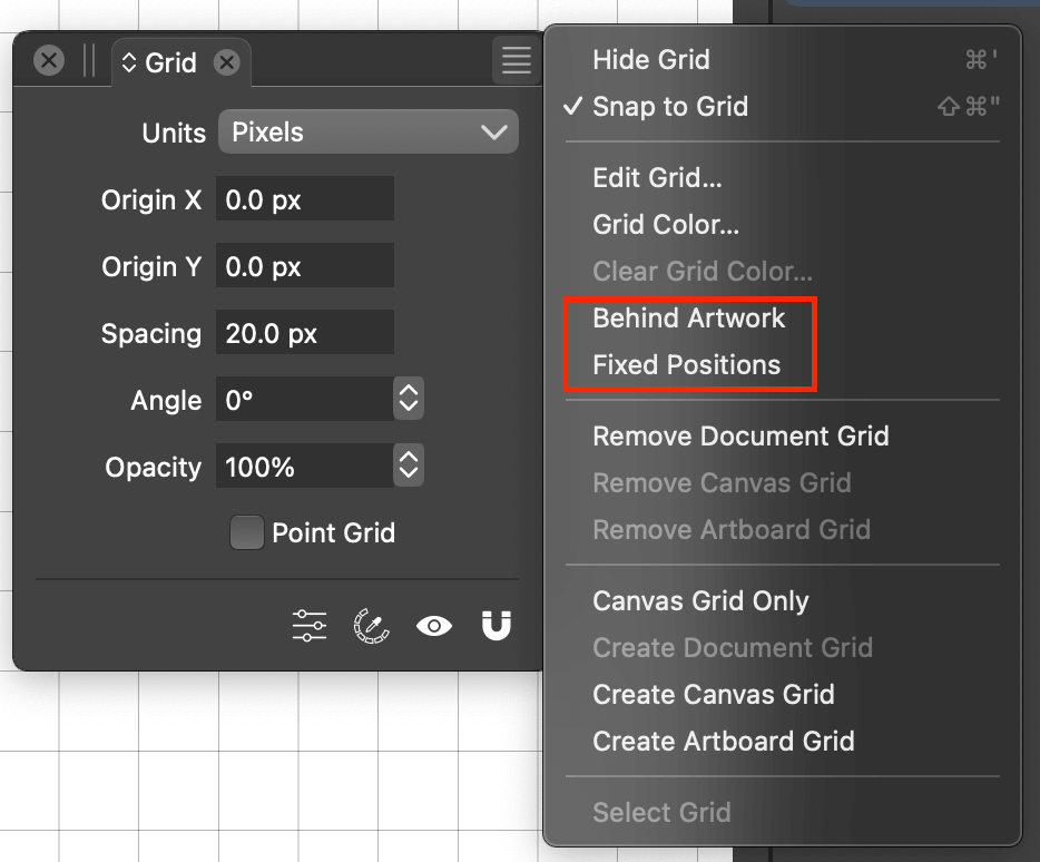

      b77 @pentool
      @VectorStyler 'Behind Artwork' is the same with 'Background Grid' checkbox
      in the Grid Editor.
      'Fixed Positions' has a tooltip in the Grid Editor — 'Check to align the grid to
      fixed positions independently of the artboard position'. I enabled it but I'm
      not seeing anything different if I move the artboard. I guess I don't understand
      what it does.
        VectorStyler @pentool
        @pentool @b77 Added these to the backlog, will get back with more later.
          VectorStyler @b77
          @b77 said in DOCUMENTATION: No definition for a few Grid menu items:
          What is the artboard position? if it is a multiple of the grid space than this option has no effect.
            b77 @VectorStyler
            @VectorStyler The size of the artboard doesn't seem to matter — moving or scaling the
            artboard leaves the (default) grid unmoved no matter if 'Fixed Positions' is enabled or not.
            So I still don't understand what 'Fixed Positions' should do. I thought it should move the
            grid when you move the artboard. 🙂
              VectorStyler @b77
              @b77 Test with this file: 0_1691573687231_pagegrid1.vstyler
              Make sure that the Grid panel menu -> Select grid -> Artboard Grid is checked.
                b77 @VectorStyler
                @VectorStyler It works with your file as it should. 👍
                But it doesn't work with this one, and the 'Select Grid' submenu is greyed out here.
                0_1691574165942_ds.vstyler
                This one with the default grid:
                0_1691575000941_ds_default grid.vstyler
                  VectorStyler @b77
                  @b77 These files have a canvas wide grid. The option works on artboard grids only.
                  Maybe it should be greyed out for canvas grid.
