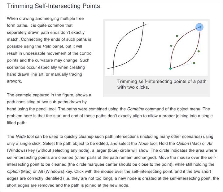

            This might be a case of outdated documentation, but was this section a solution for this before the "Trim and Join" tool was added? I can't get it to work but it might just be me
            https://www.vectorstyler.com/documentation/shapes/editpath/

              pentool @Boldline
              @Boldline The one in the documentation... I've tried that before, too. It does work in a way that first you need to combine them per docs. But then it only joins them and doesn't remove the extra segments. They become separated but you have to manually delete them.
                @Boldline The Trim and Join tool should work for this.
