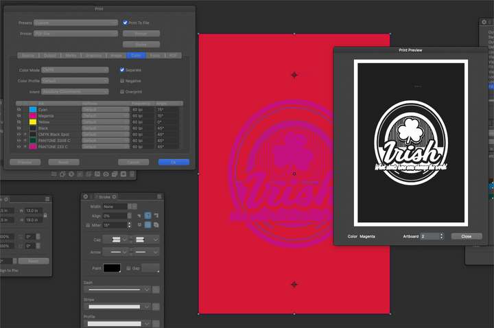

          @VectorStyler ok but for me it shows up as a color to print in the print panel. I used red as the artboard color because nothing in my design has red in it - it's showing as a spot color and also the Magenta and Yellow both have it as part of the print preview
          0_1692380249682_1d6db25e-cc95-404d-952a-6df169f61366-BLD 2023-08-18 at 13.36.09.png
            @Boldline The print preview is wrong in this case.
