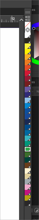

    Where do I switch options for left-click and right-click controlling fill vs stroke/front or back square, etc ?
    4 Posts 2 Posters 4.4k Views 1 Watching
      The color palette panel allows the user to left-click to change the color of whichever square , fill or stroke is in the foreground and a right-click will change the color of the background square.
      I believe it was @encart who requested the ability to make the left-click always change the fill and right-click always change the stroke, no matter which is in the foreground or background. I'm not opposed to this option and I might end up switching to that method.
      Right now, the secondary vertical palette works the way @encart suggested, but the color palette panel works the opposite way. Is there a main preferences setting I need to change either way or is it in the palette settings?

        @Boldline So you want clicking the colors in the Color Palette panel to work identical
        to clicking the colors in the Color Palette bar — left-click assigning the color to the fill
        even when the Stroke button is active?
          Boldline @b77
          @b77 To me it would make sense that it be universal - that the user could choose which method he prefers. Right now I am used to one way and when i sample colors from the other palette, I often get the wrong result.
          What would be the benefit to you for each to have it's own different selection method? Wouldn't you want it one way for all?

            @Boldline
            A Prefs setting that disables the current mode of assigning colors
            for the Color bar wouldn't hurt. (It could be that there is such a
            setting and I couldn't find it).
            What I'm not so sure of is having a setting that enables the same color
            assigning method for the Color Palette panel — it could be confusing
            because of the Fill/Stroke button combo in this panel.
            But I don't use both the Color Palette and the Color bar, so maybe I miss
            something here.
