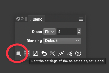

    Icon symbol in blend panel does not look correct and does not allow me to create a blend
    7 Posts 3 Posters 6.2k Views 2 Watching
      In the blend panel, the icon used to start the blend looks different than the usual three empty shapes - the middle one is filled in. I am also unable to create a blend using that button when it is like this. I tried restarting VS and it remained. I checked the blend panel on my laptop and it looks normal (three outlined shapes)
      Is there a setting that causes this? Does it represent anything? I checked the documentation but did not see anything about it

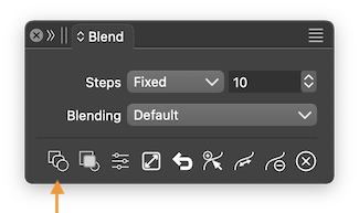

        @Boldline The button that creates a blend is not visible in
        your screenshot — make the panel wider to see it:
        As for that second button that doesn't work, seems to be a new
        addition, and I don't know what is supposed to do.
          Boldline @b77
          @b77 Doh! thank you. I feel dumb. Thanks for pointing that out. Silver lining to this thread is that we can point out the second button does not seem to be working.

            @Boldline It could be that the Blend panel was docked with other narrow panels,
            and undocking it kept the same narrow width that excludes the first button.
            Something that can be improved, @VectorStyler. 🙂

                  @Boldline Yes, that icon creates a single (new) object that is a blend of two objects. This is a 1.2 feature.
