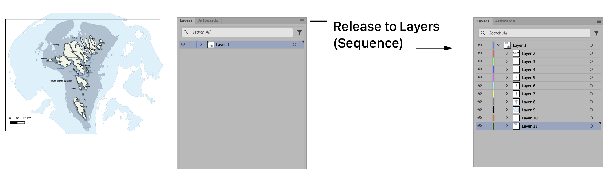

I can't get what I hoped for:Opening a QGIS svg file with the QGIS-layers saved as groups. In Illustrator I am used to opening this and clicking on layer 1 and then giving the command 'Release to Layers (sequence)'. The result is that all groups (while retaining group properties) are placed in their own layer.
Why can't I get this done in the VS with the new 'Release to Layer' function?
Example AI. -
@Ayo In VS you need to select the groups that are release to layers. I will try to improve this to work in a way that is expected.
