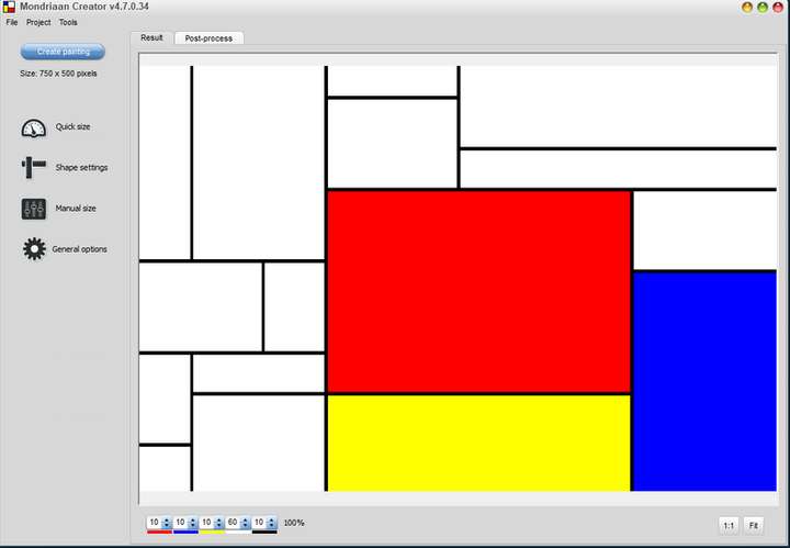

i have a Mondrian Creator for such tasks
And here a pretty good Documentation where
Artist and Scientist try to recreate a Mondrian Paint.
Can say its not a easy task.
Here the Link to the Docu
Is in German but you could use automatic subtitles in englisch
its call "Das Geheimis der Meister", "The secrets of the Master"Pic of Mondrian Creator (its free, found it on Internet once)
