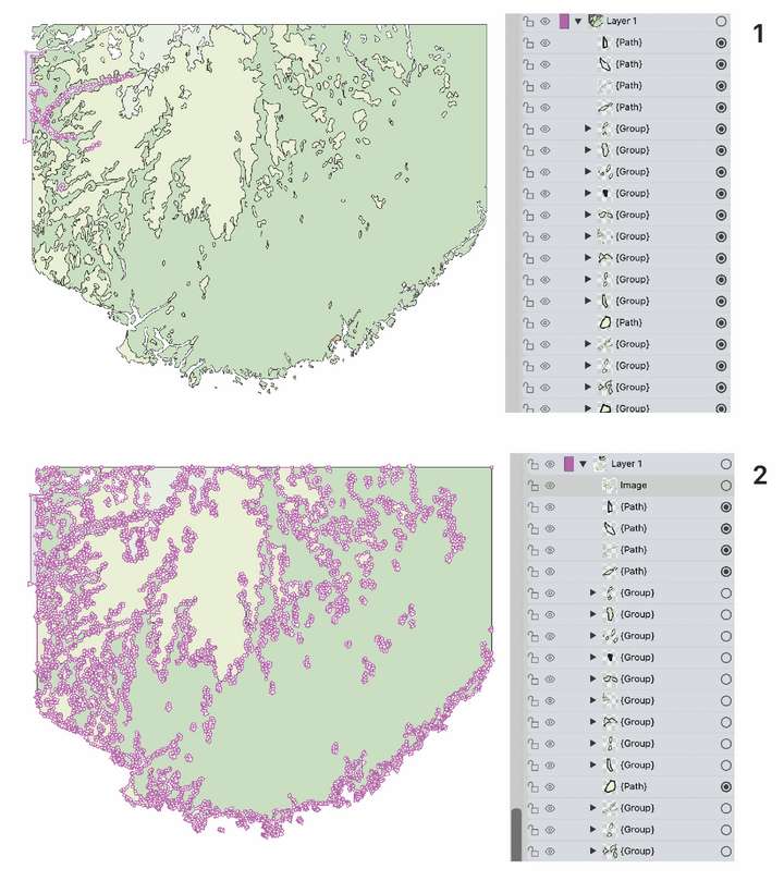

      @Ayo said in Select All Objects while working in the Node Tool:
      The radiobutton readout in the layers panel is also strangely inexplicably different.
      In case (2) the paths inside the groups are selected, but the groups are not.
      AyoA 2 Replies Last reply Reply Quote 0
      • AyoA Offline
        Ayo @VectorStyler
        Point is:
        Assignment 'select All' one way or the other, should that differ?
        ('Cmd-A' or 'drag maquee select')
        Cmd-A within a selection (all the nodes of a selected object) is another thing.

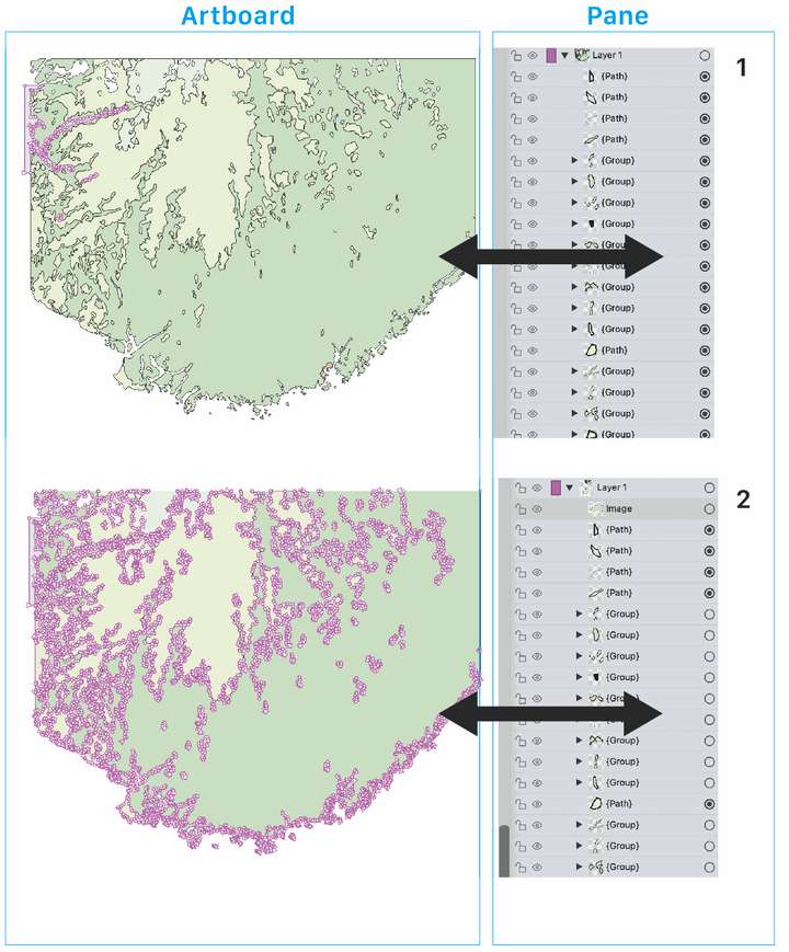

          Ayo @VectorStyler
          Second:
          Is left the proper visual representation of right? Or vice versa?
            VectorStyler @Ayo
            There is a bit of difference between "Select All" for objects and "Select All" for Nodes.
            In the first case (objects), the groups are selected (not their members).
            In the second case the members of the groups are selected (not the groups), unless the group has a clipping shape.
              VectorStyler @Ayo
              Not sure of case (1), was it selected as Objects or as Nodes?
              Case (2) looks right, all nodes seem to be selected, if you look into the Groups in the Layers panel, the objects inside should be marked.
              But there is an other idea here: should the dot indicate if a member object is selected? Maybe with a light grey spot?
              • AyoA Offline
                Ayo @VectorStyler
                Both 'Select All' selection examples are while working in Node Tool mode.
                1. 'Cmd-A'
                2. drag marquee select
                In my understanding, you should get the same result in a different way.
                Your theoretical explanation may be correct, but as a careless user I have to deal with what I see and get in return in the form of visual feedback on my own actions. There is no developer sitting next to me. So...
                WYSYWYG
                Should 'should the dot indicate if a member object is selected? Maybe with a light gray spot?' NO please no more vague highlighting in the layers pane!
                Selection indicators on the artboard are more direct and easier to read and understand than scrolling and counting dots in the layers panel. In my opinion you should be able to work with the layers closed/layers only in these types of integral actions.
                Have to think about it...
                  VectorStyler @Ayo
                  Got it. I will test this more.
