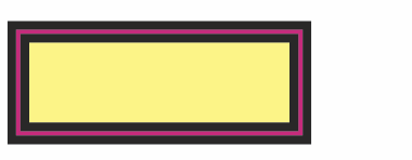

Why do I receive no feedback that an object is active (selected).
Drawing a simple rectangle on an empty artboard. This is active immediately after drawing. Seems logical to me, proof: I can change the color. However, I can't see this. No active selection frame or what so ever is shown.2
