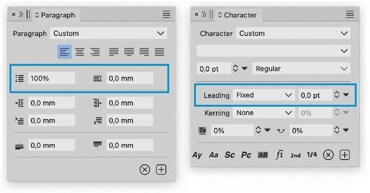

      Documentation says: Edit the extra line spacing, added to the line spacing obtained from the character heights.
      For my ignorance; what is the intended purpose of using 'Extra Line Spacing'?
      • to add on top of the % leading?
      • to make it possible to specify leading in mm? (set leading to 0.1% ((smallest value possible) then leading in mm is almost true)
        VectorStyler @Ayo
        @Ayo said in Purpose Extra Line Spacing in Paragraph Panel:
        Yes. Otherwise leading always depends on the font XHeight.
        • AyoA Offline
          Ayo @VectorStyler
          Wouldn't it be better to use the extra mm leading option as 'OR' instead of 'AND'?
          • Leading % font size
          • Leading mm
            Useful!
            The add mm on top of the % leading makes no sense to me.
            VectorStyler @Ayo
            Yes, I thought about this also, but the 'OR' mode allows for a combination of both relative and absolute expansion of line space at the same time.
            For example when we change the font, the relative leading changes (font specific) but the absolute stays.
            I think it allows for a more general combination of options.
            And the 'AND' case is still there by setting one of these to zero.

                  @VectorStyler A little more about 'leading'.
                  1. Strange that (or why is) the leading in the Character Panel is designed differently than in the Paragraph Panel.
                    Maybe a better design. The options selector solves the above problem!

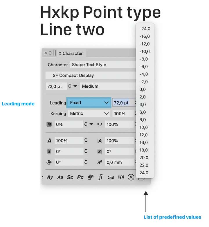

                  2. But I doubt whether the relationship between Leading Mode 'Fixed' and 'List of predefined values' gives the correct values.
                  Try it!
                    VectorStyler @Ayo
                    @Ayo I opened a bug on this one and will try to replicate it.
