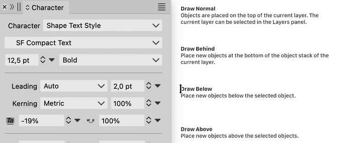

      1. Sometimes it is not possible to select text as textframe has overflowed content. Enlarging the frame until everything fits makes it possible again.
      2. Not possible to place text cursor on blank-line (also frame text)

        @Ayo Thanks for reporting this. I will try to replicate, but it could be specific to the font used.

          Its SF Compact Text. It's in the icon file I have sent to you.
            VectorStyler @Ayo
            @Ayo Got it. The cursor placing issue occurs here also. It can be moved with the arrow keys, but not with clicking.
            But I can select the text here, even if I reduce the frame size to have it overflow.
              Should be resolved anyway.
                VectorStyler @Ayo
                @Ayo said in Text-trouble:
                Yes, it is a bug.
