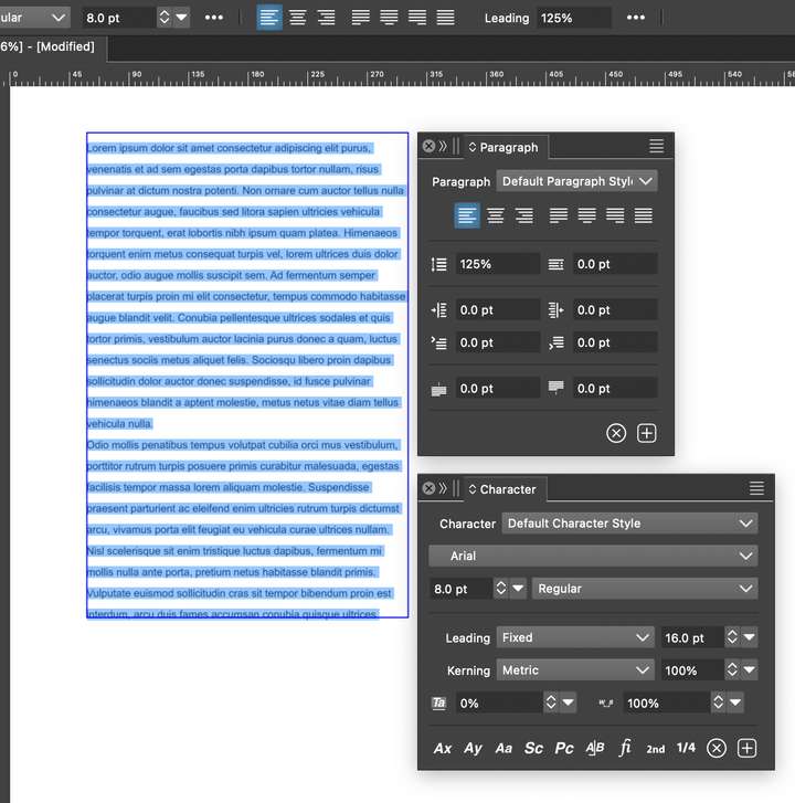

      In the paragraph panel and top context bar, the default leading method is set to % value. Is it possible to change the paragraph leading to fixed pt? Thank you

        @Kumr said in Paragraph Leading:
        I will add an option for this.
        There were other requests on similar issues.

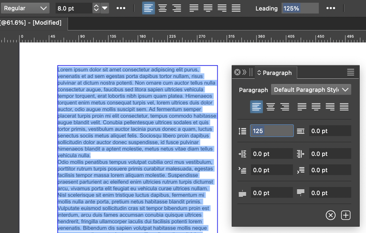

          Kumr @VectorStyler
          @VectorStyler Thanks.
          Similar leading options s are available in the character but not in paragraph panel (% value only). Changing leading value in character panel is not updating with converted values to the method used under paragraph panel or vice versa.
