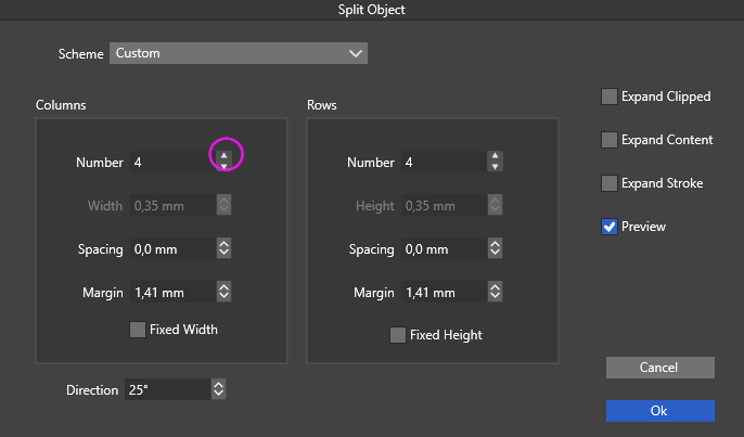

            @VectorStyler Bug report.
            Arrow button is increasing 'Number' value while the cursor is over.0_1699349344249_screenshot_20231107_102840.png
              VectorStyler @encart
              @encart said in Is there some way of cutting objects into pieces?:
              Was this by clicking on the arrow? This kind of number editor has an up / down scroll arrow (different from the other arrows, seen in Spacing).
              • encartE Online
                encart @VectorStyler
                @VectorStyler Without clicking , only hover. The others are working properly.
                  That should not happen. I tried replicating here on Windows, but could not.
                  What happens when hovering over other fields?
                  encartE 2 Replies Last reply Reply Quote 0
                  • encartE Online
                    @VectorStyler Without a single click. https://recordit.co/2GLeuN12Ov
                    • encartE Online
                      @VectorStyler I switched to another document and tried to replicate, but it works fine now. The problem has disappeared
