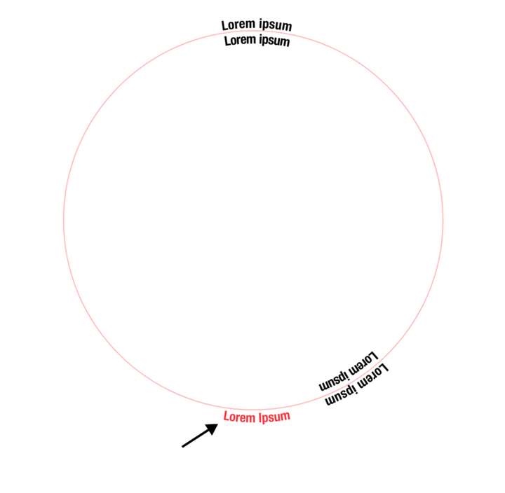

      Kumr
      Text on the path drifting towards the left when setting an offset value. 0_1700021095346_Screenshot 2023-11-15 at 9.29.41 AM.png
      https://recordit.co/fFs9DQ6tG6
      K 2 Replies Last reply Reply Quote 0

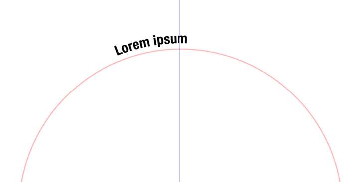

      • K Offline
        Kumr @Kumr
        The artistic text frame is shifting when I change paragraph alignment. Is there a setting where I can restrict the movement of the artistic text frame?
        https://recordit.co/vKew5BouUr

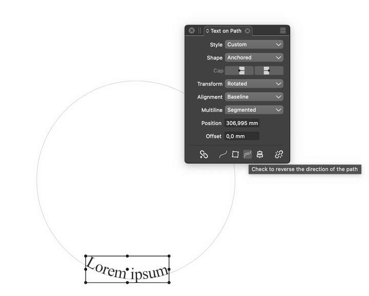

          Kumr @Kumr
          How to do change the text direction in text on path tool?
          Devil DinosaurD 1 Reply Last reply Reply Quote 0
          • Devil DinosaurD Online
            Devil Dinosaur @Kumr
            @Kumr
            Open the "Text on Path" Panel, it's on the bottom.
            Fred.
            K 1 Reply Last reply Reply Quote 1
            • K Offline
              Kumr @Devil Dinosaur
              @Devil-Dinosaur Thanks for the help. I was looking for that option.

                        Kumr @Kumr
                        @VectorStyler Looking for a solution for these two things.
                          VectorStyler @Kumr
                          @Kumr
                          In the "Text on Path" option, Radial Position should enabled and position set to 90 degree.
                          When the Radial Position is disabled, the position is given in length along the curve which is different after the curve was offset.
                          This is by design. The text alignment is relative to the text position (point text). The same happens in Illustrator.

                          • K Offline
                            Kumr @VectorStyler
                            @VectorStyler Thanks for the help. That radial position option helped. I have to spend more time on VS manual.
                            On the text frame drifting, I haven't checked how AI approaches this part, but like what AD does, keeping the frame in place. It will be difficult if the frame shifts the position every time alignment changes, particularly on circle designs with multiple text elements. I struggled with a circular infographic creative.
                            An option to keep the frame in place will be helpful at least in text on path tool.
                              VectorStyler @Kumr
                              @Kumr said in Text on path:
                              This is harder part. The text could be moved automatically, when not on the path, to accommodate the new alignment.
                              But when on the path, the position along the path must be according to the text alignment.
                              One thing I can try to do is to keep the non-radial position the same for changing offsets.
                              K 1 Reply Last reply Reply Quote 0
