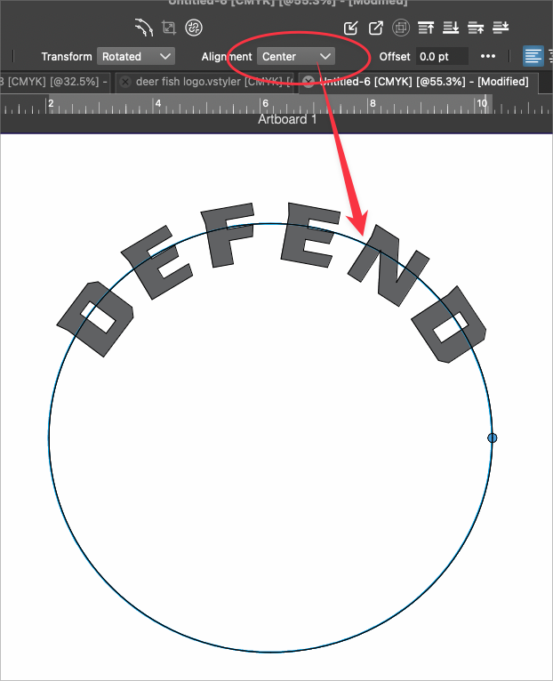

    The text on a path alignment is set to "center", but is not showing true center of font
    3 Posts 3 Posters 4.9k Views 2 Watching
      The text on a path alignment is set to "center", but this is not showing true center with the font. Is this as issue with the font?
      0_1709594118581_fc6876f5-4d71-42e4-adce-f471c04b107c-BLD 2024-03-04 at 18.13.18.png
      b77B VectorStylerV 2 Replies Last reply Reply Quote 1
        b77 @Boldline
        @Boldline Most fonts I have here look aligned correctly to the visual center,
        and a few don't (Birch Standard, Lithos Pro, Tahoma, etc).
          @Boldline What font is used here?
          The centered alignment should be about half between the ascent and descent, but it might vary based on the font.
