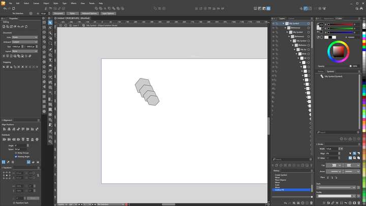

      A bit of a strange situation that is almost certainly the result of doing things the wrong way, but seems reproducible.
      • Create two objects and then group them
      • Delete one of the objects, resulting in a group with only a single member
      • Give that group a name for ease of identifying
      • Object->Object Role->Symbol on the group
      • Drag a new copy of that symbol onto the canvas from the Symbols Panel.
      • On the layers panel, drag the new {Reference} to be a child of the original symbol.
      This results in the layers panel expanding the nested symbols to a considerable depth, overflowing its usual bounds, while only displaying recursion of 3 additional layers on the actual canvas.

        @LoginError Yes, this seems to be a bug. I will try to fix this ASAP.
          VectorStyler @LoginError
          @LoginError BTW: currently the recursive symbols are cleared out when reopening the file. This is by design and will be changed in the next build.
