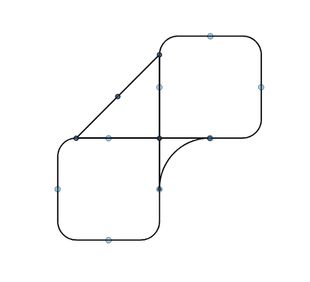

        I'm always curious about what solutions there could be,
        so I took a look.
        Here are my steps:
        put a triangle in the corner
        duplicate it, with copy and paste
        so it stay in place
        keep the duplicate selected
        use the corner tool to create a
        round corner
        select both shapes then
        select a boolean exclude (substract)
        Here a Video which shows the steps:

          My approach is a bit different. To make the shape pleasing to the eye, an arc should be made as a tangent. I have two methods for this:
          1. Using @Subpath and @encart trick in the following thread
          Screen Pal Video
          1. Using two tangent circles and the Shape Builder Tool
          Screen Pal Video
