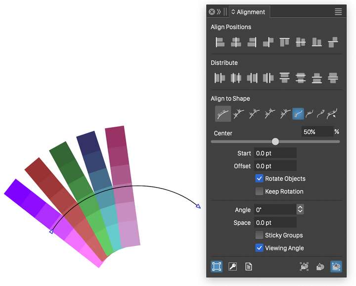

@richbyte The rectangles along the vertical direction must each be grouped. Then the resulting groups aligned to a path with the Alignment panel.
- Grouped the rectangles.
- Registration point to bottom centre for both the group and all rectangles.
- Chose - Align to Shape
- Selected all and then selected the circle as key object

@richbyte The "Align on Shape" alignment options must be activated from the panel menu.
@Subpath Appreciate your help. This is interesting using transform.Thank you!
@VectorStyler This worked. I had the "Align on Shape" activated. The circle(key object) was too small, your illustration help figure it out (The arc). Thank you!
