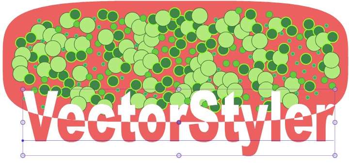

                  @VectorStyler Thanks. It works indeed by grouping the shape & the text. The text remains editable. However, after having applied the boolean operation (minus), I can't apply any effect to it (e.g., Repeater) or at least it is not visible:

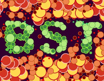

                          @William-Kansepa The "erase" function is indeed interesting, but here I've tried to use VS to create a fully editable design with two mutually exclusive containers filled with symbols (editable) with the Repeater function (editable), like this:
                          but this is not fully editable for one of the containers. If I want to modify the design, I have to start all over again. What I can't manage to do is create two mutually exclusive containers that are fully editable, and my idea only works on this condition ☺

                              @VectorStyler I didn't save the last file but I just recreated one (two artboards). However, I've had some VS crashes and I haven't finished the one on the right. File sent.
                                VectorStyler @B-Vs-V
                                @Pat Got the file. This case resulted from creating a composite shape from two repeater objects (with shapes). This will not combine the second repeater content.
                                I think the desired result can be achieved by first creating the composite shape (solid fill) and then adding a repeater.
