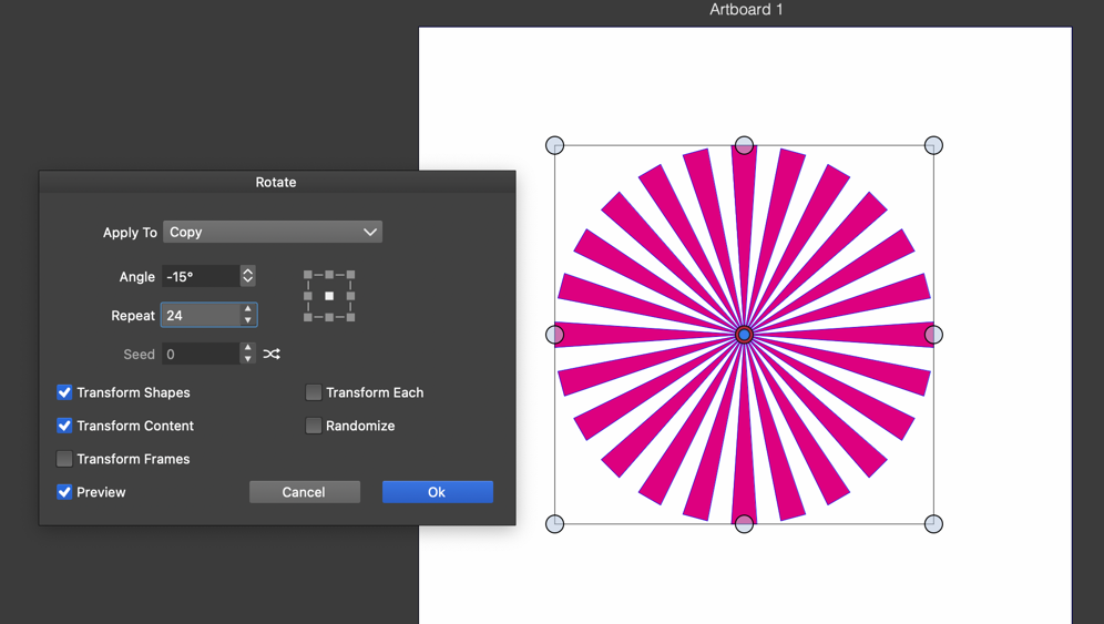

      When using the rotate tool to create a radial repeat, I was wondering if there was a way to set it to set the repeat to end perfectly?

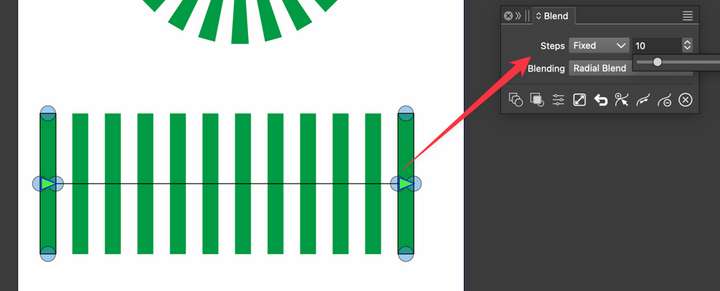

        isnt "align to shape" such a way
        here a Video
          @Boldline said in Is there a way to auto-set spacing when creating a radial repeat so it spaces perfectly?:
          No option for this, but you can type into angle a 360 / 24 (or any value from the repeat field).
