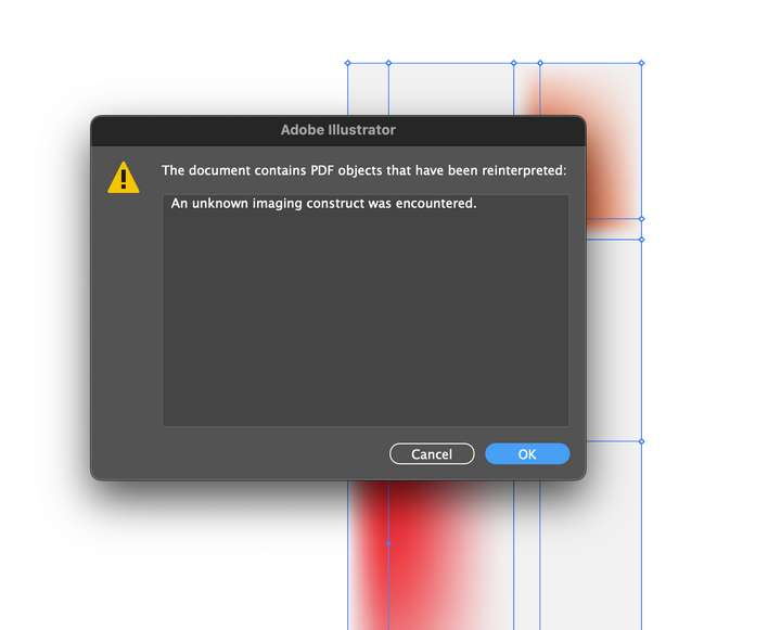

          Ok, Thanks. I am able to open AI Mesh gradients object (both AI/ PDF exported files) in VS, and even edit the points and change colors. AI displays the following message when I open PDF (VS exported) and opens the mesh gradients as image objects.
          Attaching the VS file
            VectorStyler @Kumr
            @Kumr said in Mesh Gradients as styles:
            I will try to find out what can cause this.
