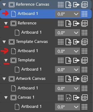

      Sorry to revisit this point ☺ , but I'd like to make the most of VS's special features including "special" Canvas.
      If I've understood everything correctly, by default there's a Canva Reference and a Canva Template, so you can include a special artboard in your workflow to place objects defined as references or symbols (or characterised by a specific style that can be reused). Placing these objects alone does not define them as such. We have to do that later, OK. Why is there a default Artboard and a sub-menu with a new Artboard?
      When placed on these Canvas, are these "References" or "Symbols" objects automatically available for other new documents (or do we have to save or export them as such or 'I don't know'?)?
      If, by default, these objects are just objects with no specific "definition", what's the point of using these particular Canvas?
      Thanks ☺
        VectorStyler @B-Vs-V
        @Pat said in Using Canvas in the workflow:
        The artboards in the canvas category (first level) are a regression from the last build. Artboards can be added there too manually, but it should be none by default.

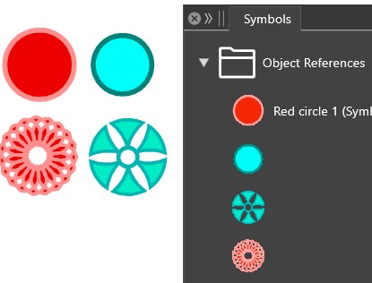

        Not in other documents (unless linked with Document Links). Also: for Reference canvases you must enable a "Role" in the Canvas Options. Then all objects on that canvas will appear as some Style or Symbol based on the Role.

          I was just struggling with this matter, criticizing the complexity. Searching the forum and manual for an explanation. Triggered by why the PDF generation has an extra board. But things might be different.
          If I understand correctly, is B the correct representation?
              Yes, and the bug is fixed now, the fix will be in the next build.

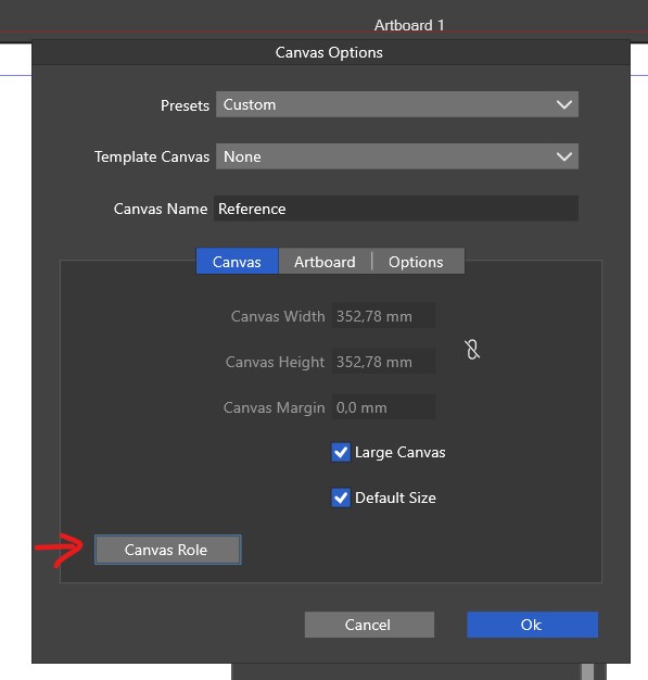

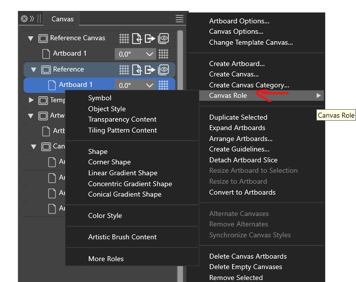

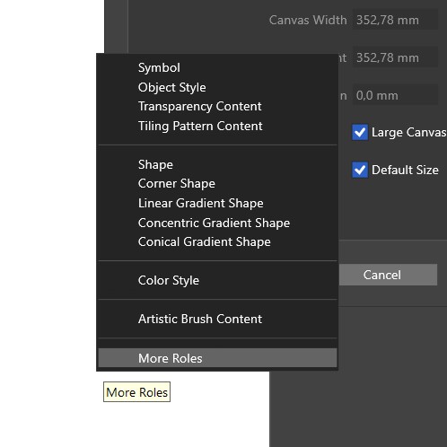

                        @VectorStyler So I see two 3 ways of specifying the "nature" of a Canva: via the VS menu or via the Canvas panel menu or the Canva options. I assume they're all identical.
                        What is a Canva defined as Shape Canva ? etc.

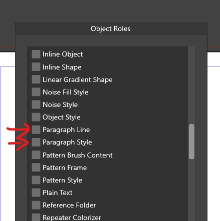

                        I also notice that there's a long list of parameters for defining the nature of a canva:
                        For example, if I choose "Paragraph style", all the styles I define on this specific artboard of this specific Canva will be styles I can apply to the design of artwork-type artbords?
                        What is 'Paragraph line' ?

                            What is a Canvas defined as Shape Canvas ? etc.
                            The shape of the objects on that canvas will become shape styles. Just like fill or stroke, in VS you can have shape styles that control the shape of the objects.

                            I also notice that there's a long list of parameters for defining the nature of a canvas:
                            yes, same list as for the "Object Role", these are possible attributes use as styles.
                            For example, if I choose "Paragraph style", all the styles I define on this specific artboard of this specific Canvas will be styles I can apply to the design of artwork-type artbords?
                            In this case the paragraph formatting of text objects on the reference canvas will act as paragraph styles, that are listed in the "Paragraph Styles" panel and can be used as regular paragraph styles on the Artwork canvas.

                                      @Pat @VectorStyler So the way to utilize this is if I had a collection of objects I want to use as symbols in future projects, I could create a new file and define it with the symbol attribute and everything I build or paste in there becomes a symbol. Then If I have that symbol file opened alongside a new file I am working on, if I drag or paste from the symbol file into a new file, it will get pasted as a symbol?
                                        @Boldline said in Using Canvas in the workflow:
                                        Yes, when pasted onto a reference canvas with the Symbol role enabled.
                                        Also: Open an AI file with tiling patterns, symbols or brushes and explore the canvases under the reference canvas category (not sure how this goes with older AI versions). This will give access to the content of those symbols, patterns or brushes.
