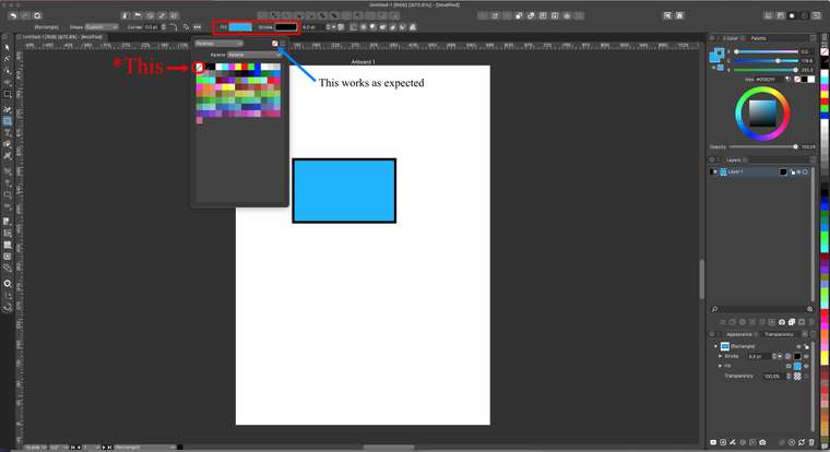

    Is the first box at the top left left hand corner of the group of color boxes in the Color Palette supposed to be a “No fill" (or No stroke) icon ? (Context Panel> Fill (or Stroke)> Drop-down menu> Palettes).
    It looks like the typical red forward-slash in a white box icon for that function. No description pops up when you hover over it as well (another bug???)
    It’s just to the left of the black box that says “registration” as you hover over it.
    If it is a “no fill" or "no stroke" icon, it’s not working. It does nothing I can see.
    The icon to the left of the flyout menu does indeed make the selected object have No Fill (or No Stroke) as expected.

    No, not the Color Palette rows across the bottom.
    I am talking about the when you access using the Context Panel at the top, below the main window.
    1). Draw an object
    2). Click on the Fill (or Stroke, either way) color box from Context Panel at the top os the screen
    3). Click the Drop-down arrow (so you can change from the default "Color" to what you want)
    4). In this case, from Drop-down menu, change the check mark from "Color" and put the check next to Palettes
    The Palette color boxes appear (13 columns, 9 rows).
    Look for the first box at the top left left hand corner of the group of color boxes in the Palette. It looks like the typical red forward-slash in a white box icon (it’s just to the left of the black box that says “registration” as you hover over it)
    There is no "tool tip" when you hover over it.
    When you click it, it doesn't work (but the other "no fill" icon in the upper right part of the panel, next to the fly-out menu, does produce the expected result)
    Here is a screen shot with Fill selected. The same happens for Stroke as well:
    0_1620199314988_VectorStyler_Context-Panel_Palettes_No-Fill_No-Stroke_Not-Working_Screen Shot_with-Edits_ZZZ_JPEG.jpg
    As @fde101 pointed out, hovering over the "no fill" icon for the Color Palette at the bottom of the screen does not provide a "tool tip" (description).

    I discovered that I could rename that palette entry, and after doing so, the tooltip is fixed (it looks like it started with a blank name), but the appearance also changed: it now behaves like a normal color palette entry with a solid white color.
    There is definitely a bug here but I'm not sure what it is. The entry itself seems unnecessary given that there is already the item @Vector-Rock pointed out in the upper-right corner of the popup which does the job. I'm not sure if this was an earlier idea about where to put that which was then discarded but never fully cleaned up after or what might be going on here, but I'm quite sure it was not meant to behave the way it is.
    I also see no way to revert that entry back now that I've renamed it.
    @Vector-Rock The no fill selection from the popover fill palette list is fixed in 1.0.025
