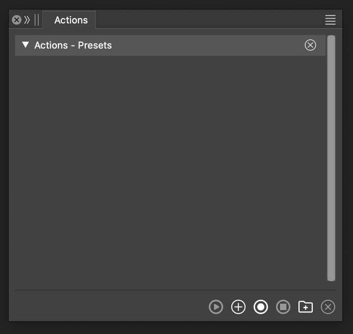

@pentool The actions can be loaded here. I used the actions panel.
Is the Actions panel empty before you try loading the actions?
Yes.
Here's a video. The Actions panel does open with the same title as the file but the actions are missing.
Also, notice after I open the file, the Actions panel keeps docking with a panel group that I have minimzed. I separate the Actions panel from the group, open the file again, and the Actions panel got grouped again with the other minimzed panels. This should not be the case unless I specifically group the Actions panel with the rest.

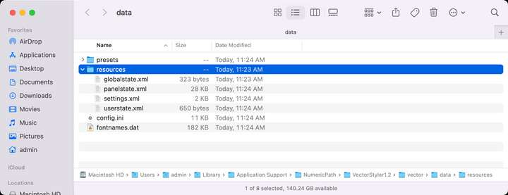

One thing: some workspace / settings issue might have accumulated from previous updates (I always have the default workspace to start a test). Try removing the settings / workspace files (back them up).
It's not enough to just download the file. You need to open it as well from the Actions Panel.
I removed the entire "resources" folder (see screenshot) and restarted the application. I have also tried "Help > Restore Defaults". None solved the issue so far.

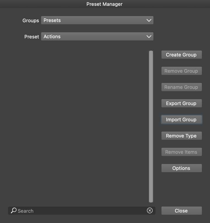

Another test: can you open the file in the Styles -> Presets Manager?
A last resort thing: remove (backup first) the whole "VectorStyler1.2" folder in the Application Support/NumericPath/
remove, download and install VS again, restore the license key in "VectorStyler1.2/vector/" folder. -
@pentool How about any other preset type: can they be saved and reloaded from ".preset" files ?
@VectorStyler The "Styles > Preset Manager" cannot open files. There's no such option. There's only "Import Group", and that cannot open ".preset" files.
@pentool If you record some action so the Actions folder is not empty, then the Options -> Append should be able to import.

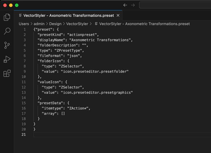

It seems the file somehow became corrupted because all of the file contents have disappeared. It had the basic, empty JSON format inside the actions preset file, but everything else was gone (eg all the data that defined the actions).
I do remember trying to change the format from JSON to XML but the file still didn't open.
Somehow the file content has disappeared and when I opened it, it just opened the blank file. I downloaded again from Dropbox and now it opens.
At this point it's still a mystery how the content disappeared from the file.

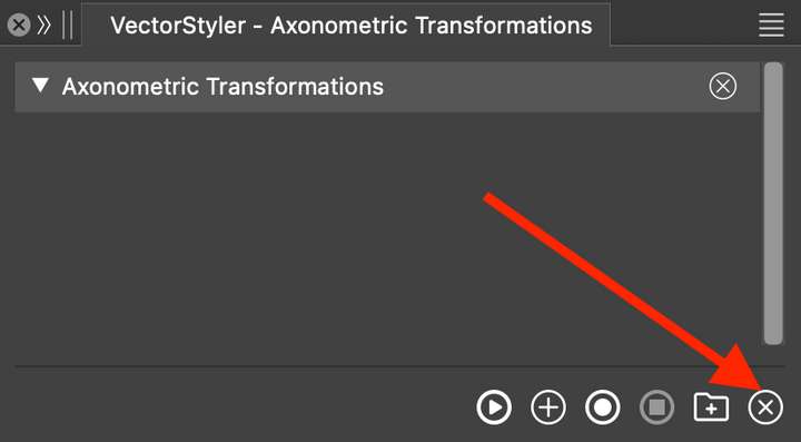

I figured out why I could not load the Actions from the file.
When you load actions from an external file and you click the rightmost icon at the bottom of the Actions palette (Remove the selected actions or folders), it not only removes the actions from the palette itself but also deletes the contents of the actions file they were loaded from. That's no good.
That icon should remove the actions from the panel only. Not from the file itself. There's not even a warning to the user that the contents of the file will be lost when pressing that icon.
In the video you can see that I start out with the original Action file and its file size is 236KB. Then, I delete the actions from the panel, and the file size will go down to 428 bytes!
All the actions will be removed from the file as you can see it here:
@pentool I opened a bug on this. But if the actions are selected, then they will be removed.
@pentool The content of the panel is synced with the file content, so if a preset is removed in the panel, it has to be removed in the file as well.
