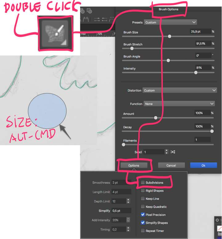

      Im looking for a "magnetic node tool", where you can move groups nodes with a fall-off effect. The fall-of radius must be variable by choice (like ie. the width of a pen).
      I use it in ie. Blender, Moho and to some extend its available in Inkscape too, and it's creatively very usefull when manipulating shapes with many nodes.
      Where can I find something similar in VS?

        @Raaskot No such feature in VS. The closest thing could be the Liquefy tool (in the toolbox with the effects tools).

          That's nice, thanks
          With liquid-tool/magnetic I find options I need: Interactive control of fall-off/"brush"-size and the option to transform node clusters without adding new segments.
          Very useful when adjusting shapes to a background sketch without metriculously tracing it segment by segment
