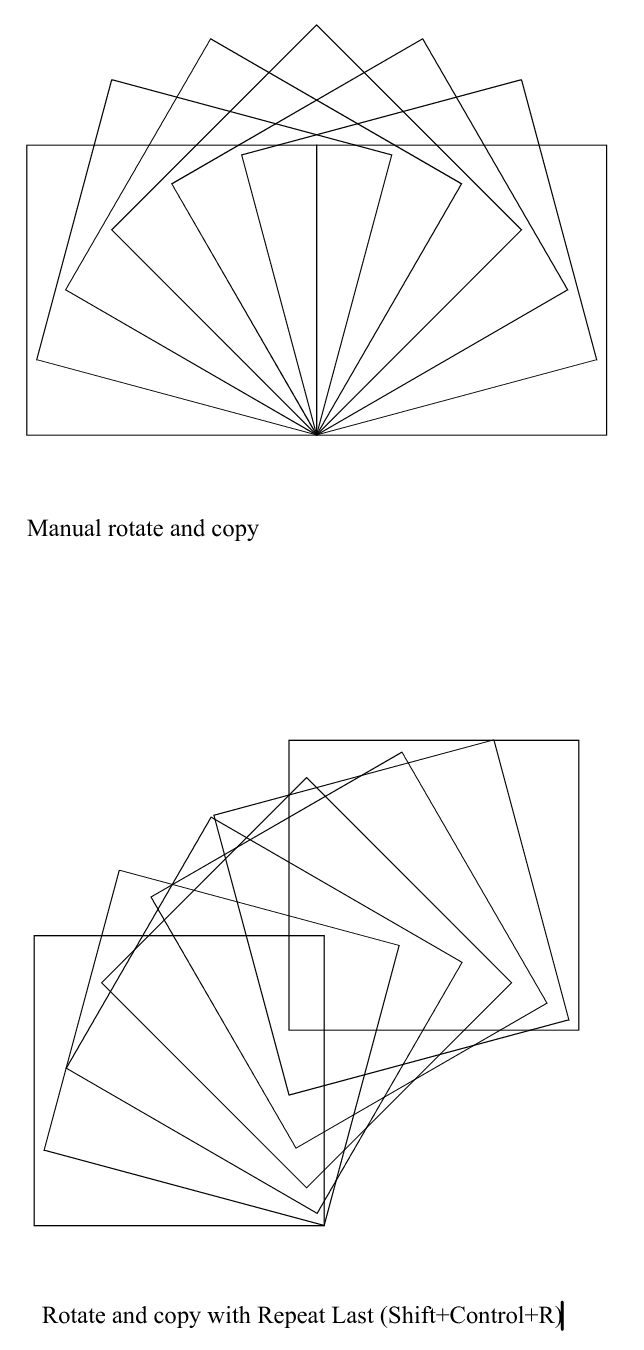

      Hi,
      When I draw an object, and move the rotation center (the orange dot) to the lower right corner, and then rotate and copy the object manually (with shift+alt), the copy rotates around the ornange dot.
      However, when I rotate and copy once, and then use the Repeat Last command, the copy rotates, but the resulting copy is offset.
      I tried looking if there was an option somewhere that enables this offset, but the only one I found was the Duplicate Offset, which I have set to 0,0.
      Is this offset intended, and if so, can it be turned off?

        @Gremriel I checked this and it looks like repeat last takes the rotation center from the new bounding box.
        An other way to do repeated rotation is to use Object -> Transform -> Rotate and set the Apply To to Copy, set the angle, number of repetitions, and rotation corner.

          That works, thanks.
