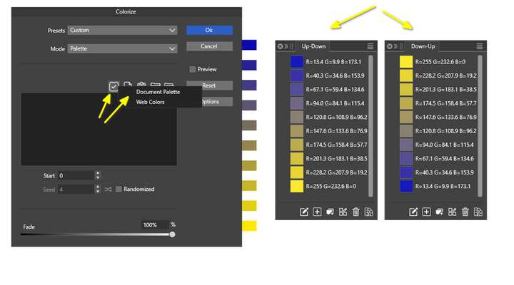

      I'm surprised that the color palettes I created, which where saved and then loaded and displayed in VS
      are not displayed in the Colorize Effect. They have to be loaded separately again
      even though they are actually already there.
        VectorStyler @Subpath
        @Subpath These are separate palette files?
        I think those are not listed, unless they were saved in a "palette folder" (see Settings -> Folders).
          Subpath @VectorStyler
          yes, i saved them elsewhere in my project folder

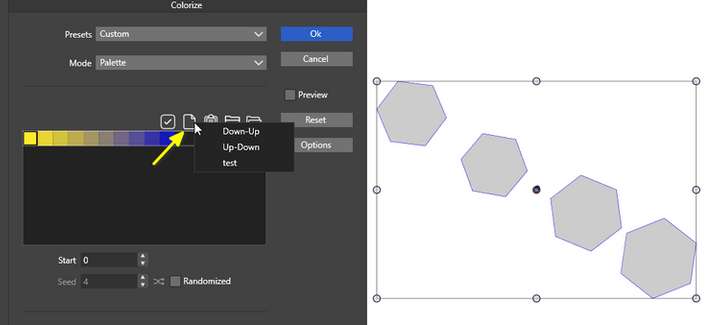

          Edited, to make things clearer for other user:
          You can save your own Color Palettes in a Folder you like,
          but if you like to use them with the Colorize Feature
          you have to register that Folder. It need to be added to the
          Color Palettes List in VS Settings:
          Settings > Folders > Palette Folders
          Then this palettes will be listet in the Colorize Feature
          here a picture
