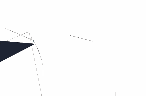

          @EricP The problem occurs because there are a lot of very thin small objects in this trace result, and intersection breaks with these (this is a bug that I will try to fix).

          But there is a workaround:
          • open the Magic Wand panel and expand it (with the knob in the title).
          • disable the Inside View option in the panel menu.
          • disable all, and enable the Thinness option.
          • select the magic wand tool and click on one of these thin shapes.
          • there should be over 14000 of these.
          • delete all these small shapes.
          • also: remove the stroke from all these objects
          • then intersection should work.
