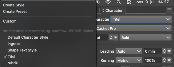

      In other apps one can define a character/paragraph style and update it in the following proces, like select, change size and update. How is this done in VS?
        VectorStyler @Raaskot
        @Raaskot Select the text and with the Panels -> Styles -> Character (or Paragraph) Styles panel, press the 4th panel button.

          Got it 👍
