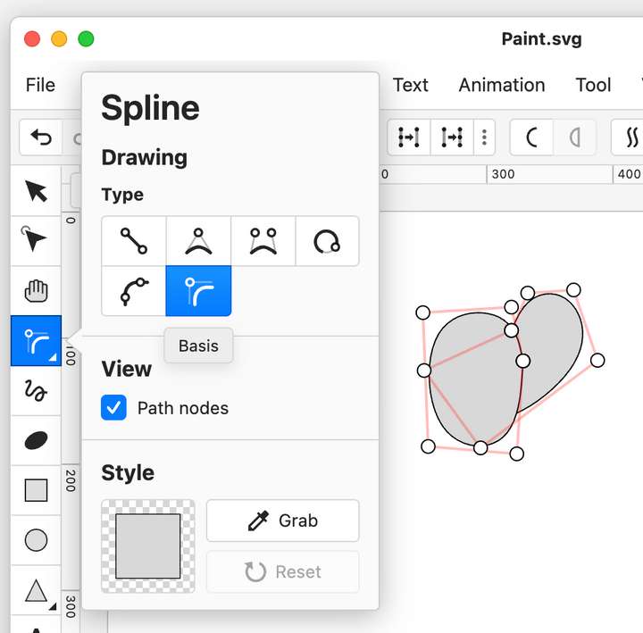

                  If you go to this URL:
                  https://boxy-svg.com/
                  And then click on the round spline tool with the single dot [see screen shot] you can see what drawing with a 3-point curve looks and feels like. It is really good for making vectors that are NOT tracing. Bezier curves with the handles are better for tracing existing images, like using a transparent layer. I would be the happiest man on earth if 3-point curves came to VectorStyler. 🙂
