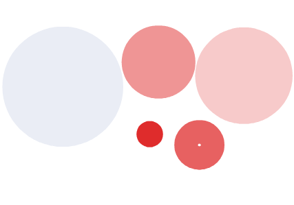

      I searched the documentation for this command, but it wasn't there. This isn't a bug, so I'm posting this here (sorry if it doesn't belong here). I'd like to know what exactly this command does, especially after using the Contour tool.

        @MrDixioner I will add this to the documentation.
        For the Contour effect: expand appearance will expand the contour into a group of objects containing the shapes used to create the contour.

          @MrDixioner said in Expand Appearance is not documented:
          ... I'd like to know what exactly this command does, especially after using the Contour tool...
          Here a little video about it

            @Subpath Now I understand how it works. Thanks a lot for the video!
