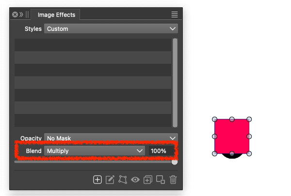

      I want to have the red square to multiply blend or darken the shape below, but cannot figure out how it works. In other drawing programmes you set blending mode in layer settings, but how do I make this in VS?
        VectorStyler @Raaskot
        @Raaskot That panel sets the blending mode for Image Effects.
        Use the Transparency panel to set object blending mode
        • RaaskotR Offline
          Raaskot @VectorStyler
          @VectorStyler Got it, thanks.
