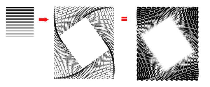

      Using Blend wouldn't work in all cases.
      Sometimes you have multiple objects, in my case, multiple paths,
      where you want to assign a slightly different style to each path.
      At the moment, you have to do this for each individual path by hand.
      That's why I thought a style picker that works with multiple objects
      would be helpful.
      In terms of functionality, you could perhaps group the paths/shapes
      you want to transfer and group also the paths/shapes that should
      receive the styles, and then use the style picker to select the group
      whose style you want to transfer.
      Here a picture to illustrat this.

        @Subpath I added this to the backlog for the Style Picker.
        This feature exists for object styling, but not for the Style Picker.
        • create a group from the first picture (the lines).
        • in Object Options, give a name, and in Role select "Object Style"
        • also in Role select More Roles and check "Group Styling", then confirm the Object Options
        • now the Styles panel will have a style with the above name (Object Reference -> Object Style -> <name>)
        • make a group of the second picture
        • apply the object style to the group.
          Subpath @VectorStyler
          Great !
          ...This feature exists for object styling...
          VS never cease to amaze me ☺ 👍
