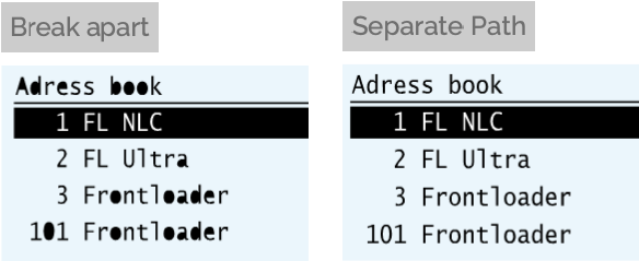

      How can I do something similar in VS?
      Attempting to do this in VS with the aforementioned method does not work. Any suggestion for alternative approach?
      https://somup.com/cTlblZRdUW

        You have to break the nodes with the Node tool (buttons in context panel), break the shapes apart and then group the resulting objects.

          Hm. Tried it out: thinks Separate Path combined with Ungroup works best for me. With Break the exclusions (ie. in "O"s) are eliminated.
            Boldline @Raaskot
            @Raaskot in case it helps, when using the break option, the interior fills of enclosed shapes can be made a different color and then merged and then deleted, revealing an empty space again.
            Break does not act like unite Boolean for example, all pieces remain albeit the same color

              Thanks😊 Yet if there's many shapes with exclusions it may (ie texts) it may be cumbersome. Is there a dedicated function for this?
              @Boldline said in How do I select and cmd-G grouped shapes to a new group?:
