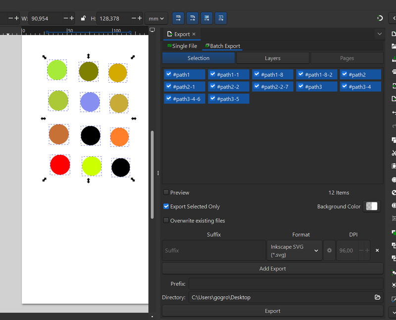

      I'm missing a feature that allows me to export selected objects as
      individual SVG files.
      For example: 10 selected objects would be exported into a folder,
      e.g., as Name_1.svg ... Name_10.svg.
      Inkscape offers this feature.
      Here a pic of inkscape solution

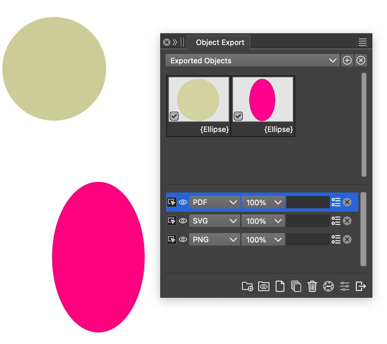

        @Subpath Thsi can be done, but only through the object export panel, but adding the selected object as separate export objects (possible with a single click).
          Subpath @VectorStyler
          Dont know how.
          Could you describe the steps needed ?
            VectorStyler @Subpath
            @Subpath
            Select the objects and in the Windows -> Editing -> Object Export panel click the 3rd button
            Set up the file formats in the panel.
            Now either use the panel menu Export All,
            or checkmark individual objects from the panel to be exported with the last button of the panel.
