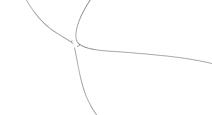

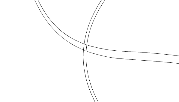

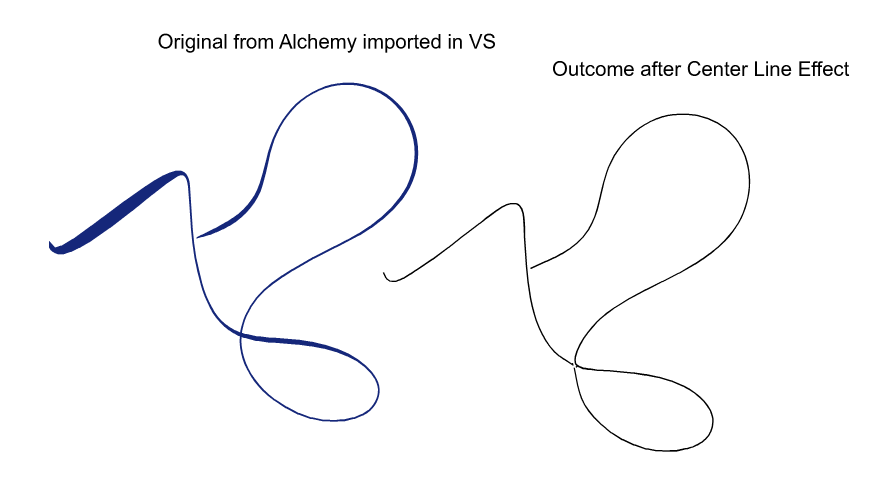

      Here some Pics to show the problem
      the Result after center line

          @Subpath The "center line" effect cannot handle self intersecting paths. This is inherent to the algorithm.

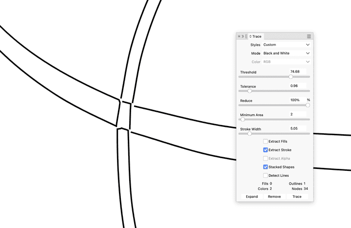

              @Subpath I've played a little bit with screenshots of this page. I'm not sure why you would use centerline effect at all for this, especially on 2nd example which only has thin lines.
              Centerline would work if you trace the image using "Extract Fills", where you end up with closed shape outlining the black pixels of your original image (stroke empty, fill black). Then applying centerline would "skeletonize" the mask and find the median paths of this closed shape (with artifacts at intersections).
              Another approach would be to trace using the "Extract Stroke" method where you directly end up with open paths and you don't need to apply centerline effect. It's not perfect either but seems a more direct approach.
              This is what I got using low resolution screenshots. You'd probably get better results with higher resolution images
