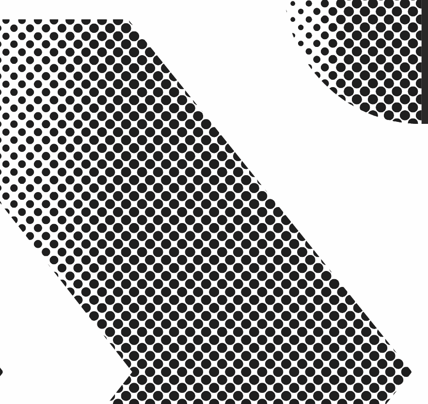

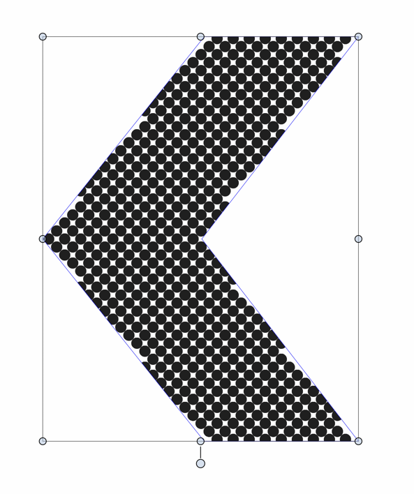

      Current issue:
      When a halftone is applied to a shape, dots near the edge can disappear if their center point falls outside the shape. For production artwork, especially screen print style halftones, it would be useful to allow partial dots at the boundary.
      I have a halftone tool requested option:
      Add a setting in the Halftone panel such as “Allow Partial Edge Dots” or “Generate Beyond Shape.”
      Suggested controls:
      • Enable/disable partial edge dots
      • Overscan amount
      • Clip to object shape
      • Expand edge dots as clipped vector shapes
      Use case:
      This would create clean halftone fills where circles continue to the very edge of a shape and are cut off by the boundary, instead of stopping before the edge.
      Current situation:
      Desired option result in image below:

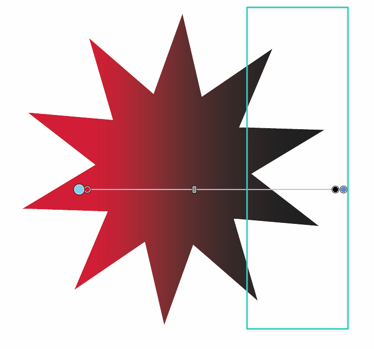

            Boldline @Boldline
            expounding on my earlier answer - you replied, "
            @VectorStyler said in option for vector halftones to generate dots beyond the object boundary, then clip them to the object shape.:
            The halftone approximates the object color / intensity. But what intensity is is beyond the object boundary? This is hard to know, especially for images.
            I was thinking of it similarly to how gradients work.
            With a gradient, the control line and color stops can extend outside the visible object boundary. The user can define color/intensity behavior in an unseen area, and the object simply displays the clipped result inside its shape.
            Could halftones have a comparable “source area” or “generation area”?
            The object shape would remain the visible clipping boundary, but the halftone grid/intensity field could be generated from a larger editable area, similar to how a gradient line extends beyond the object.
            So instead of asking VectorStyler to guess intensity outside the object, the user would explicitly define it through the halftone source/generation area.
            Possible model:
            1. Object shape = visible clipping boundary
            2. Halftone source area = where the dot field/intensity is generated
            3. Dots are generated across that source area
            4. Final result is clipped to the object shape
            This would allow partial edge dots without requiring VectorStyler to infer unknown image data outside the object.
            For flat fills or uniform halftones, the outside intensity could simply continue the same value. For gradients, the existing gradient behavior could define the intensity beyond the visible object. For images, this could either be disabled or require a larger image/source area.
            Essentially, adding a halftone generation area separate from the visible clipping shape, similar to how gradient controls can extend outside an object while the final color remains clipped to the object.
